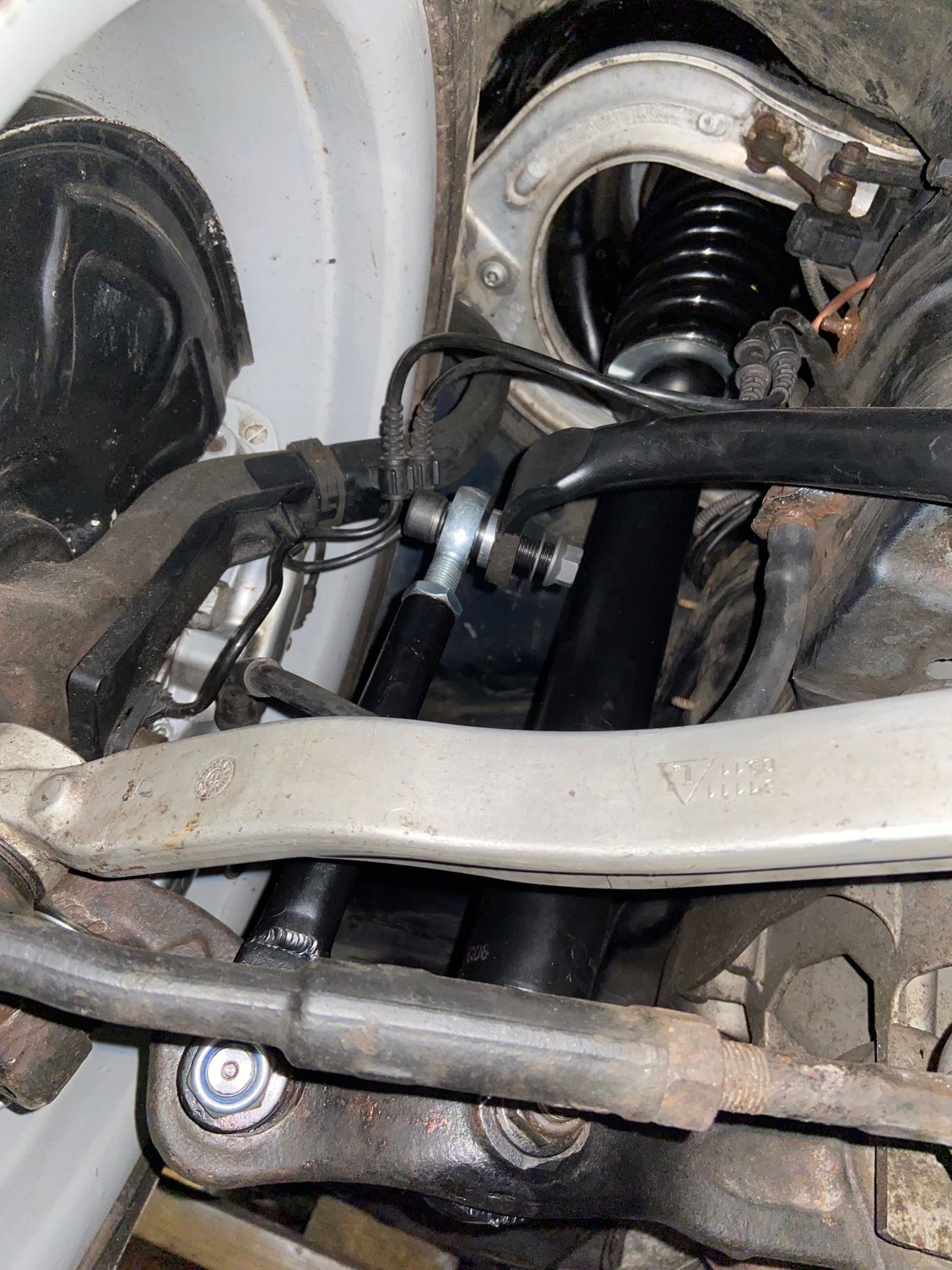

So i made some adjustable drop links , at ride height i now have sump clearance !!!!

It looks great! Congrats! Did you fabricate those links or you bought them? If so I might need those adjustable links for myself too. VVK sway bar didn't clear the SL55 sump so I got sl350 sway bar but I have feeling I need an adjustable links. I haven't finished the installation yet. Thank you!

I fabricated them , M14 Rose Joints and M14 Threaded bosses let into some Decent quality steel tube , i bought a used pair of CLS front drop links and cut the lower sections off them - they have the same Hex detail on them but were only £20 the pair off e-bay . Why didnt the VVK bar clear your sump , Sean says he makes a specific SL55 one , the SL500 only has a shallow sump ?? My only issue is at full Droop the roll bar sits up in the V of the sump , otherwise theres a good 1" of clearance at ride height , in fact the lower you go the better it gets !!

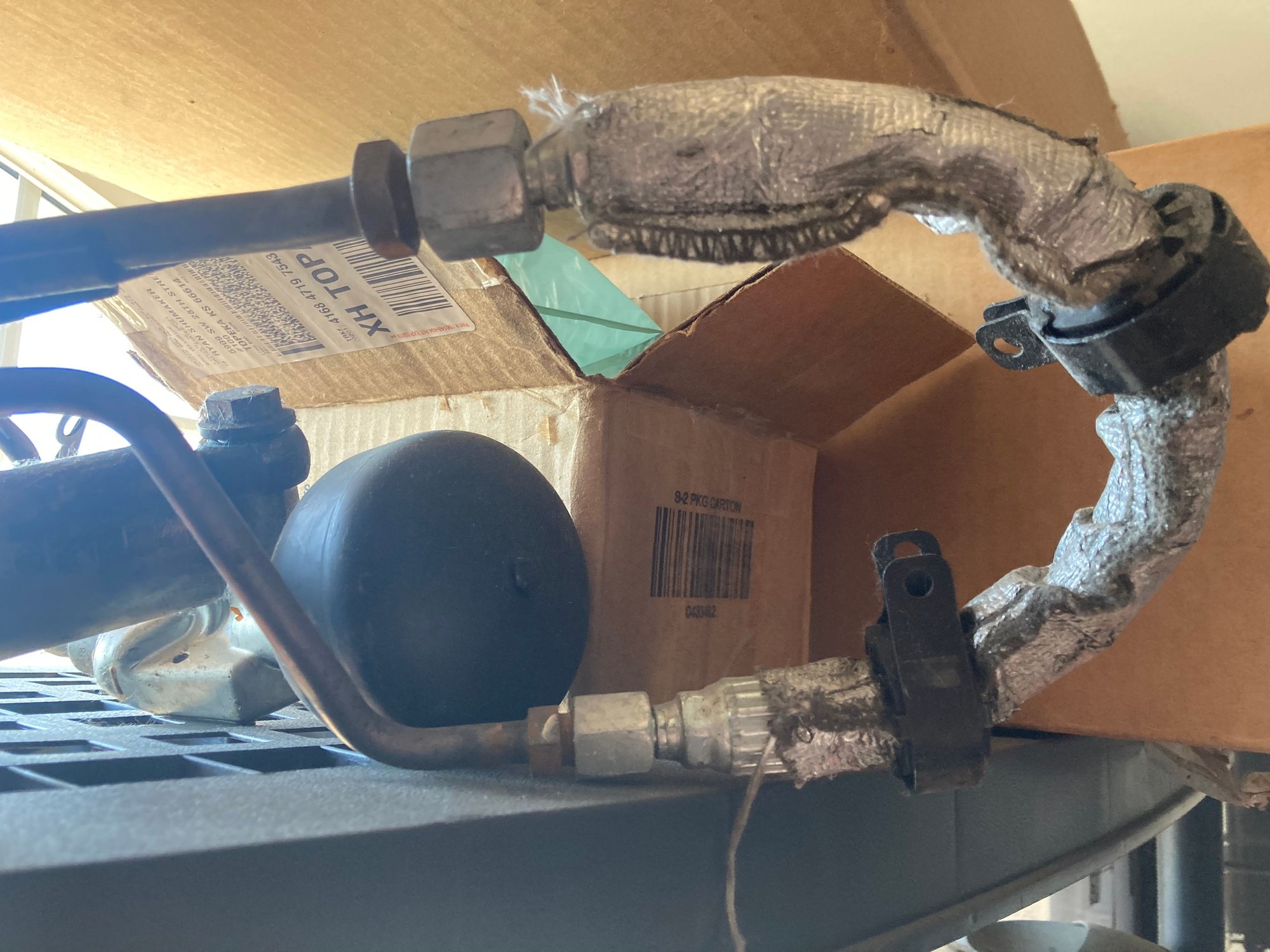

Pressure side hoses that are exposed to heat are the ones that fail. Return lines there typically aren’t issues with especially ones not in the engine compartment. These aren’t just rubber hoses they have a braided core.
The best thing you can do is protect them from heat by wrapping them. Here’s a pic showing the fittings welded on and the heat wrap I put on all the hoses. All I have to do in the future is detach the flexible rubber part of the line and have that part rebuilt. This was cheaper than buying new from Mercedes’ too.
Reply 0
