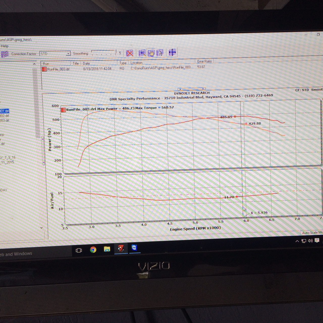

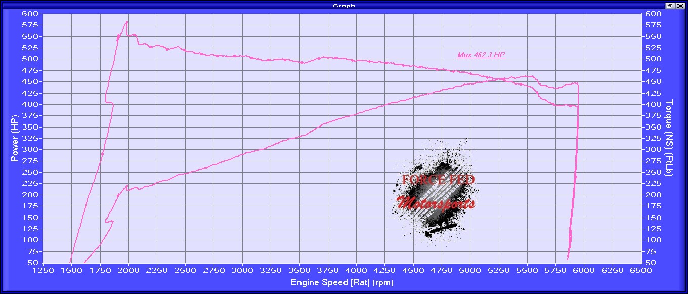

Here are some before (stock) and after (77 mm pulley) dyno results on my car.
The "tuned" results are a safe tune installed by Eurocharged on a Dyno Day, as I did get 504 RWHP on a different dyno run that morning.
500 RWHP is about the limit, unless you "open the box" to more modifications.
Attached Thumbnails Pulley guys....77mm or 83mm pulley (SL55)-gh-2007-sl55-stock-3-18-16.jpg   Pulley guys....77mm or 83mm pulley (SL55)-gh-2007-sl55-tuned-8-19-16.jpg

do a search for the 180mm crank pulley as it is the equivalent to a 77mm supercharger pulley.
Here's a link showing comparisons of the 2
http://www.mbclub.co.uk/forums/amg-l...dyno-test.html
you can see that after 5,500 rpm how the 77mm starts falling flat on its face b/c with everything else stock it can't get enough air in or out efficiently. An 82mm TB and longtube headers would make the upper end on the 77 much better.
