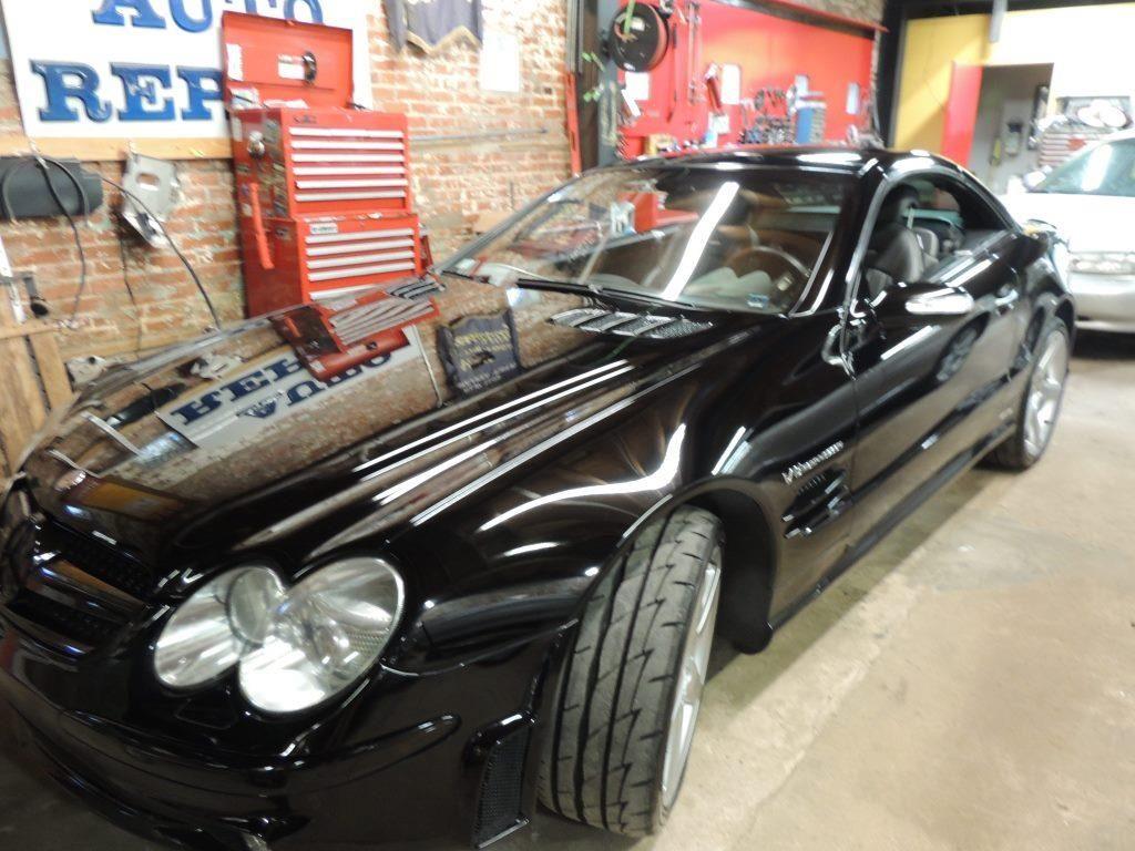

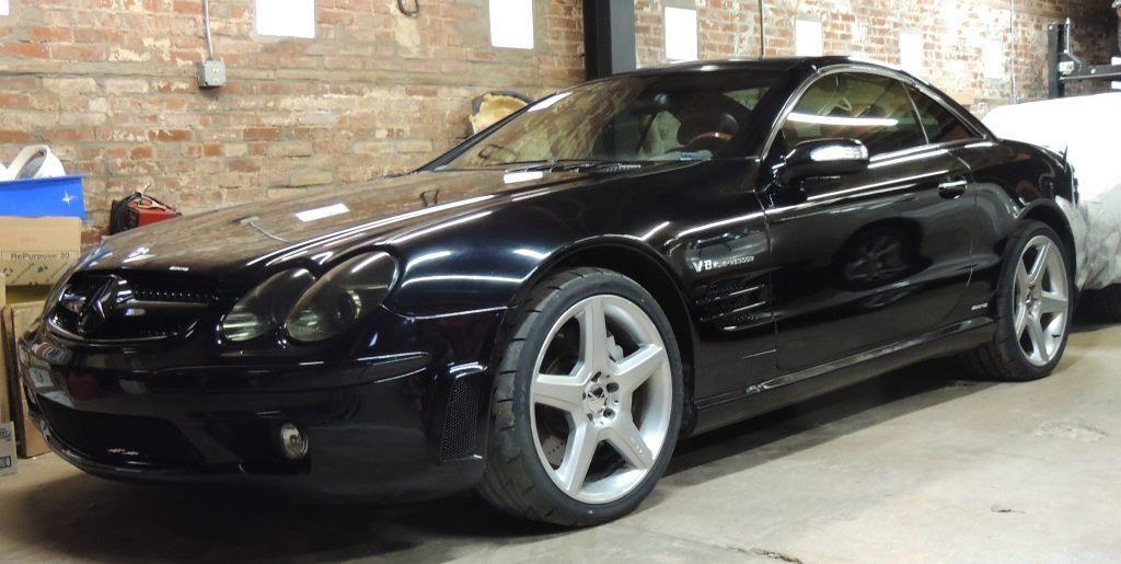

Thought I would post some pics. Still need to buff the paint; but it is in overall good condition. Just needs buffed.
I think it sits a little high. I am fine with the 19 inch wheels. Can someone confim that these are off of a later SL65?
I do not have time right now to mess with ride height, but may be able to address that when the weather cools down a bit.

Those are the standard wheels off an 07-08 SL55 AMG.

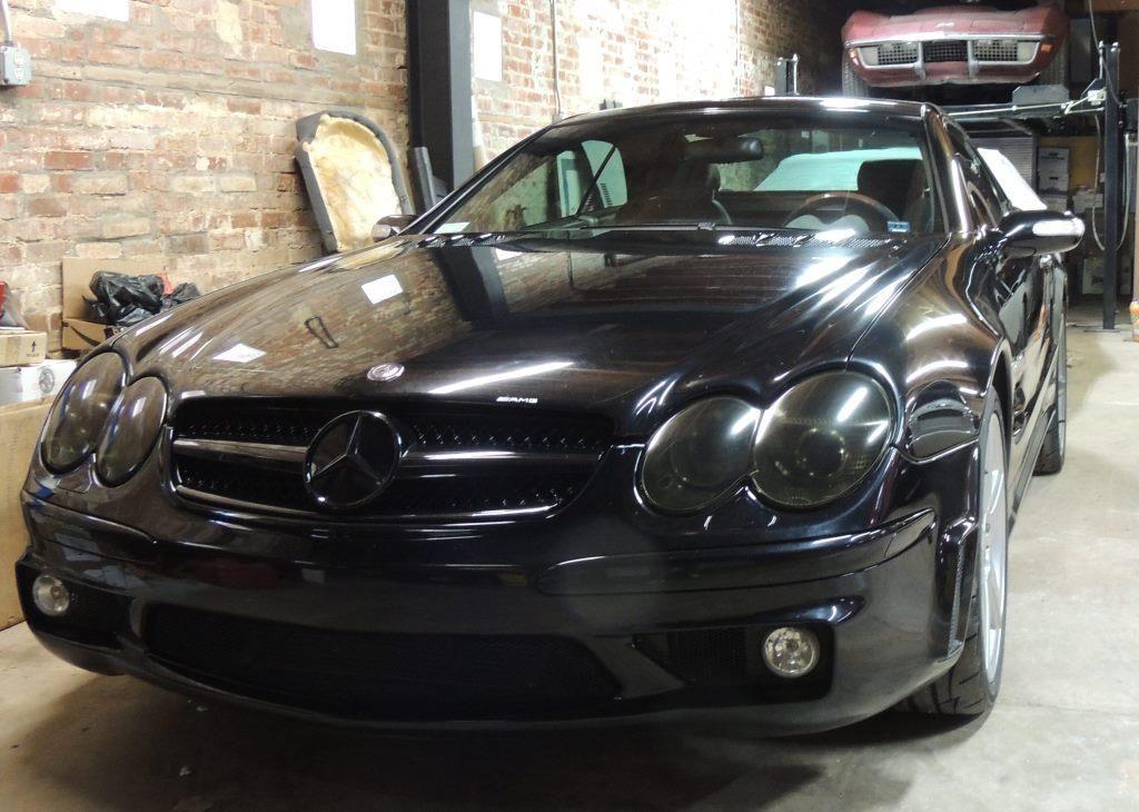

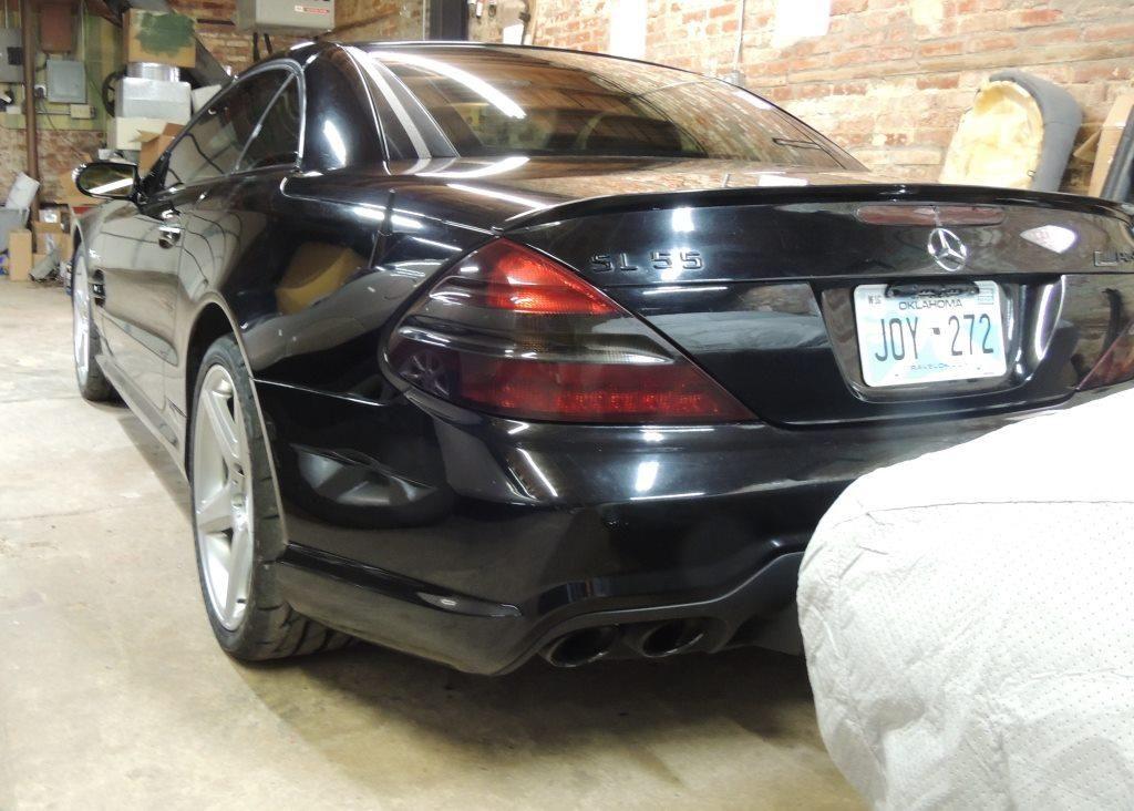

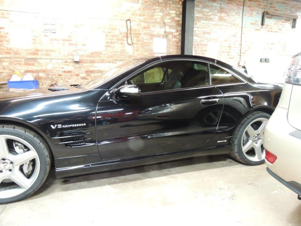

Removed the smoke covers from the headlights (can see much better at night...... wow, who knew?)
Had a local guy buff it this week. Also had some minor dents removed via PDR.
Looks a hundredt time better. Compare this to the pics above.
I can't get really good pics outside right now, as I have crammed 10 cars in my 9 car garage. Expecting rain all weekend, so may not get it out until next week.

Hey I see you have a SL65 Front Bumper on there. I have an '08 SL55 AMG that I put a SL65 front bumper on... and I'm curious... is the mesh on the side vents of the bumper on yousr stock? Or is that something someone put in later? Mine are just open right now, and I'd like to fill it some how.

I wish I could tell you. That was done by a previous owner.
I will be glad to take pics of anything you want. Let me know.

It also looks like you have a non original rear bumper/diffuser.
