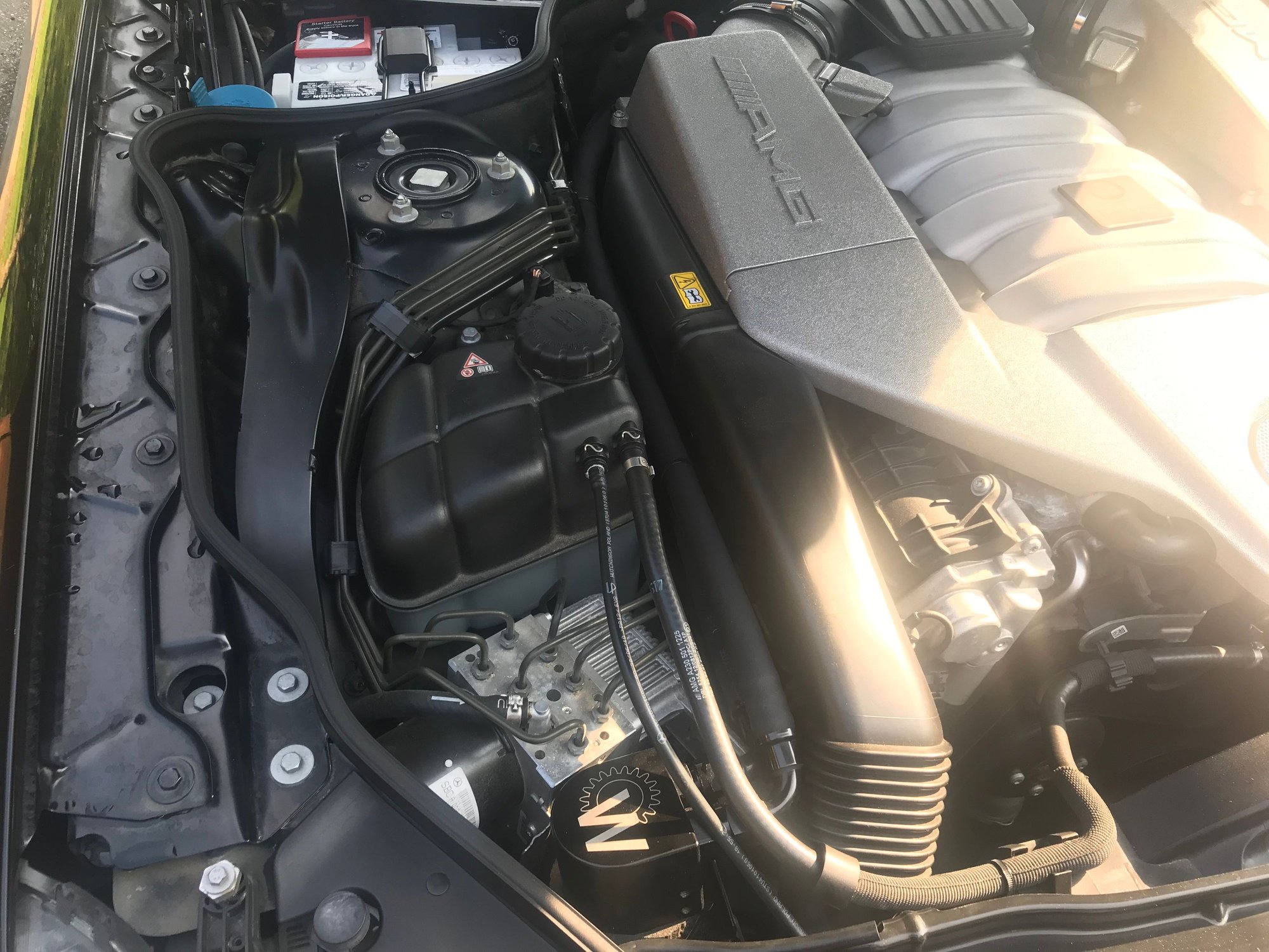

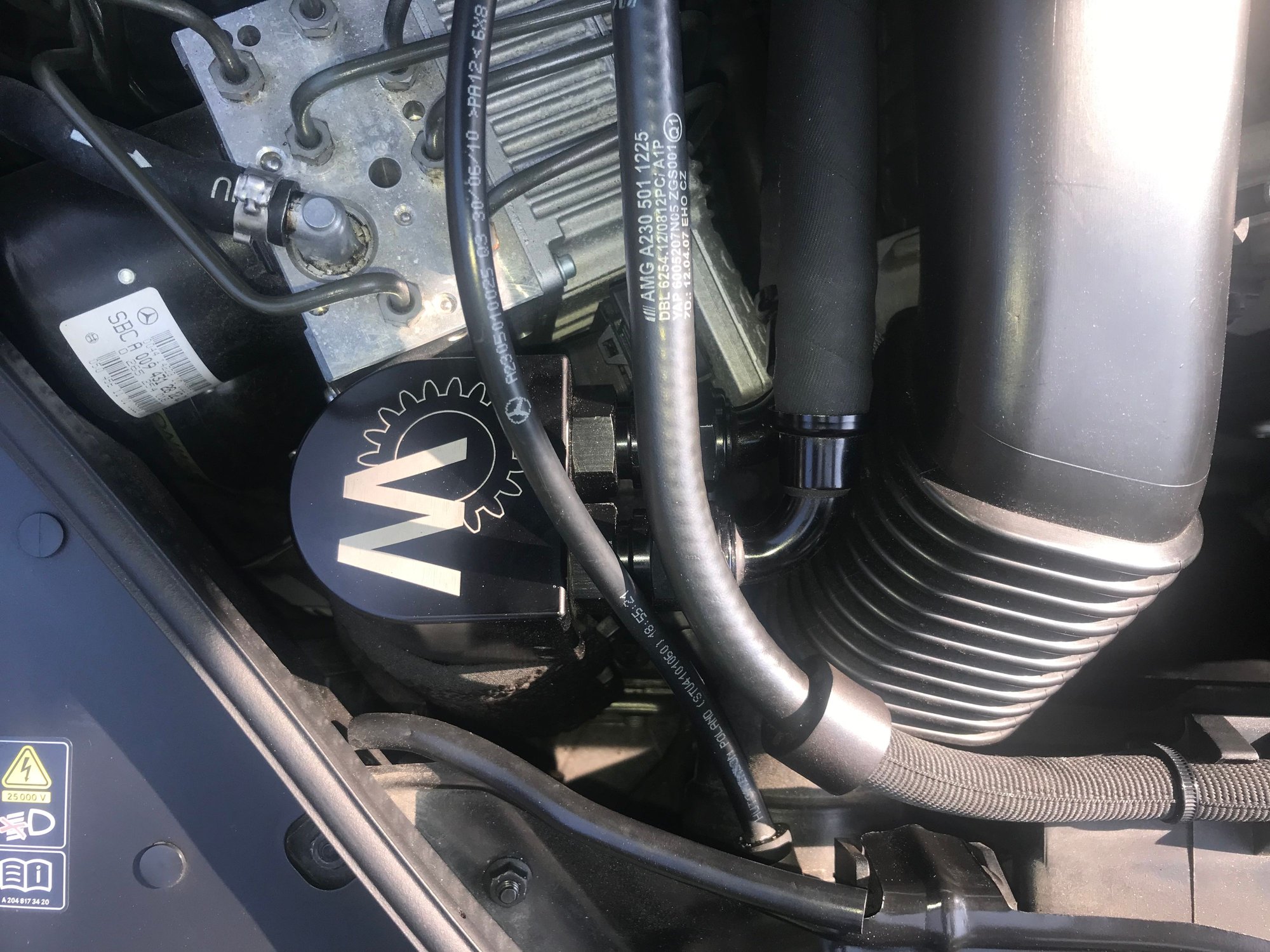

Installed mine at right front of engine bay, in the space just forward of the brake control module. Wrapped the reservoir with oil-resistant padding so no drilling/hardware required, and quick-n-ez to remove to empty.

2011 SL63 Weistec oil / air separator location
