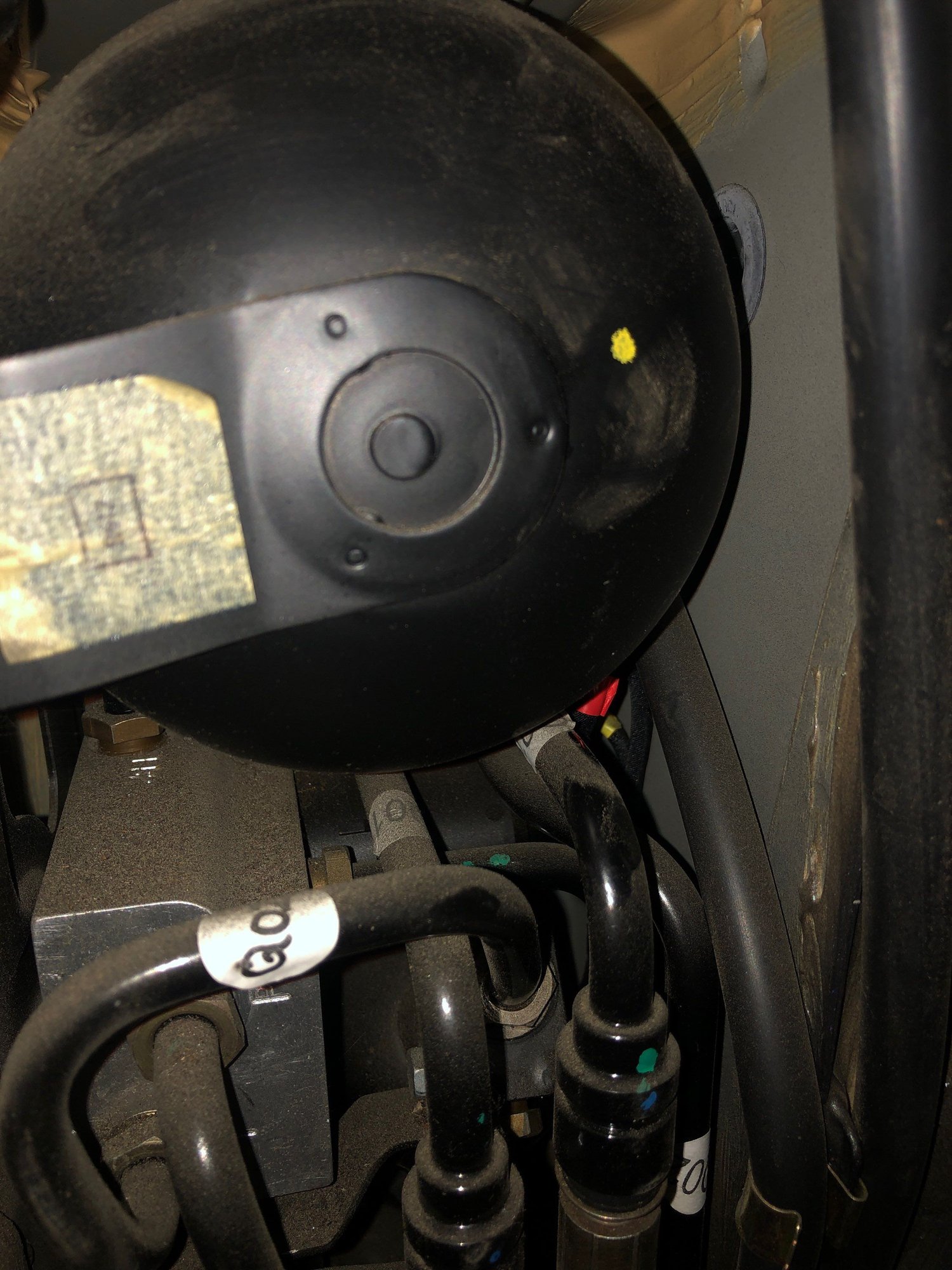

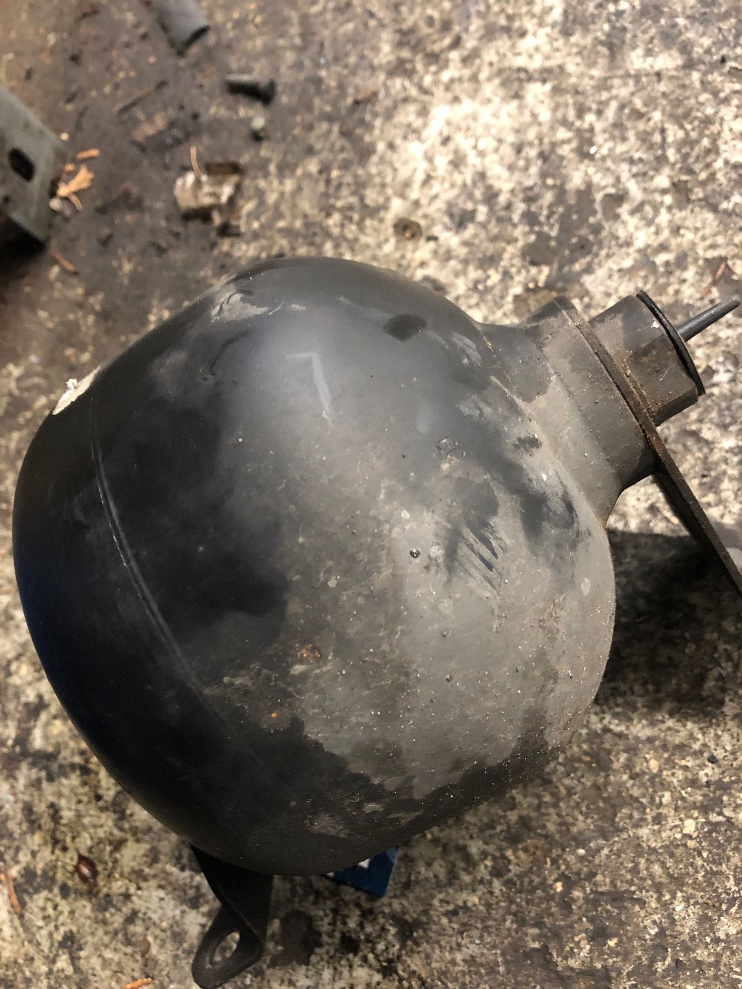

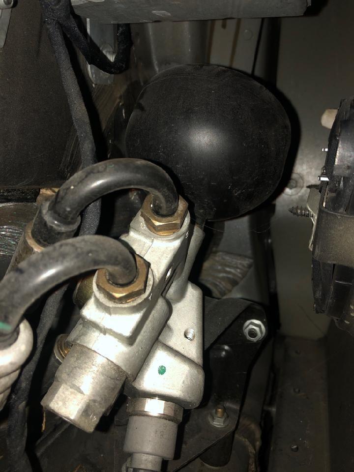

OK, so it turns out the front accumulator had the mounting bolts missing and was leaking. Rears are fine.
Leaking Front Accumulator
Looks Good !
Looks Good!
So he wants $720 to replace front accumulator and flush the system and install new filter. Seems pretty fair. He will then test drive. If I want to replace the other 2 another $740.00
