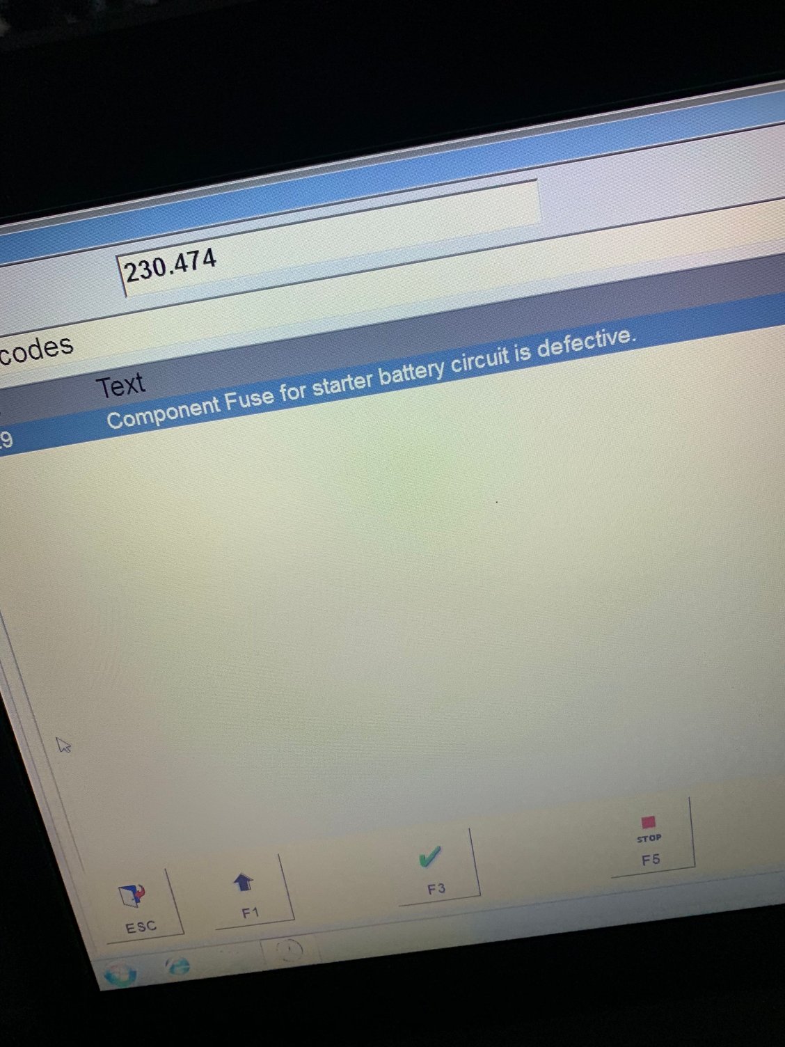

Solved:
replacing the battery tripped the “starter battery circuit” fault. Reset it and was good to go.

Aug 4, 2020 | 12:00 PM
With STARS.
Just cleared the code, and was good. Have no idea why it was tripped in the first place. I’ve replaced many Mercedes batteries in my lifetime, including for the R230.
