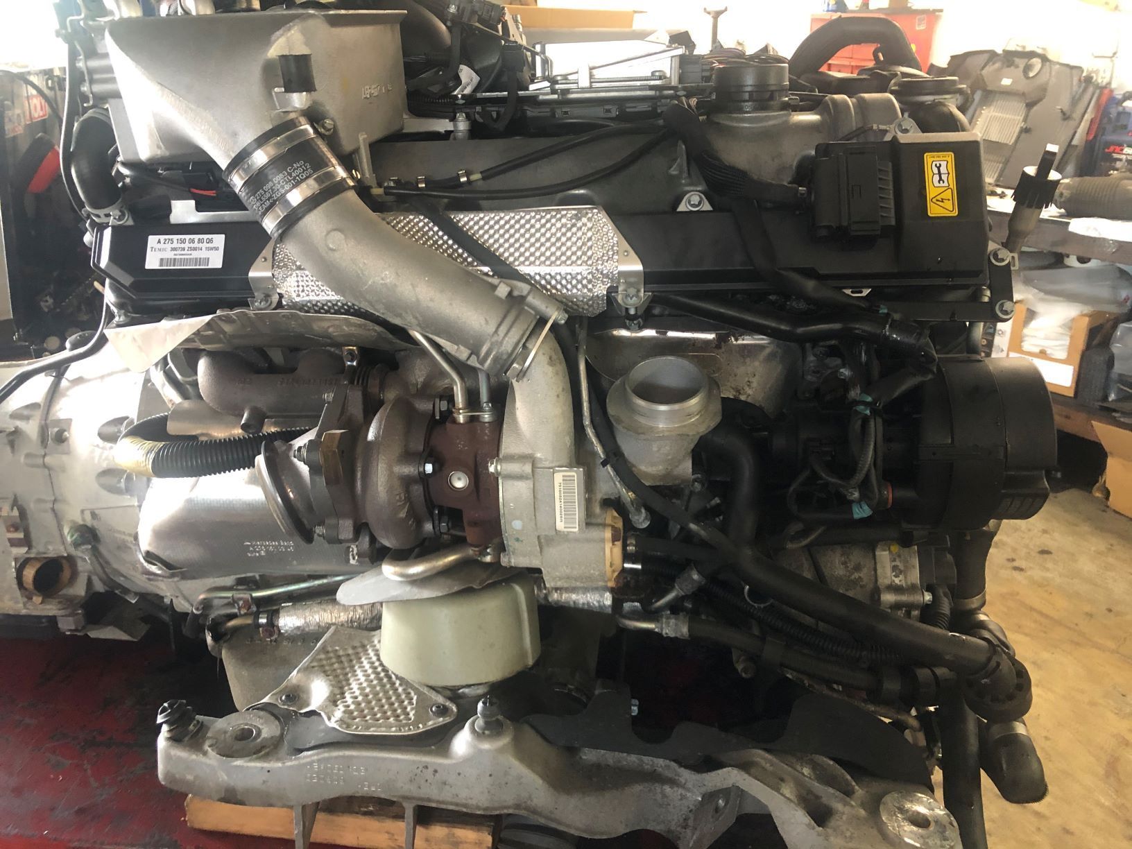

I wouldn't consider the motor mounts a preventative maintenance item. I just had mine done after spotting a leak on the left one and it's the last thing you want to do. Unlike the CL65, on the SL65 the engine has to come out to gain access. I'm envious of your new two post lift, my garage is too low to have a lift and I don't want to do the creeper, Quickjack method.

The engine mounts can be changed while keeping the engine in the bay. You need to loosen the subfame and tilt the engine to get each side in.

Like Mercedes, Alldata begins with "remove engine". The two experienced indie shops I use said the same thing. I thought the primary issue was getting access to the mount arm bolts so you can loosen them enough to lower the mount away from the turbo to get to the bolts on the mount. I'll have to go back and search here and on Benzworld again, though for me the issue is moot. A link to a step by step alternate method with photo's showing it can be done by "tilting" would be good news for SL65 owners. I didn't do the wrenching for this, so I defer to those with first hand experience.

Yes I thought I saw somewhere that they can be changed by lowering the subframe. Ill need to do more research.
