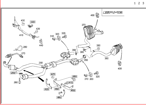

Hey I searched a good amount with no luck on this topic, had anyone put sl63 mufflers from a 09-11 on any sl55? Would it need customization?
thanks

EPC shows they size the same
here are part numbers
SL55
A2304900721
A2304900621
SL63
A2304902721
A2304902821
both have the same graphic
