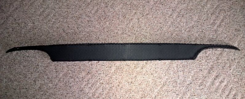

Figured out how to remove the mesh grill from the rear bumper of my 2004 SL55 AMG.
First I raised the SL off the ground using jacks and put in on four ramps, one under each tire ( I have extra wide ramps so my 295 tires would fit ), keeping the jacks in place for safety.
With room to work now, I then removed the rear splash panel from under the car which is attached to the rear bumper and bottom of the car, 4 torx screws, 6 - 10mm nuts and a Dorman interior trim panel fastener ( go figure ).

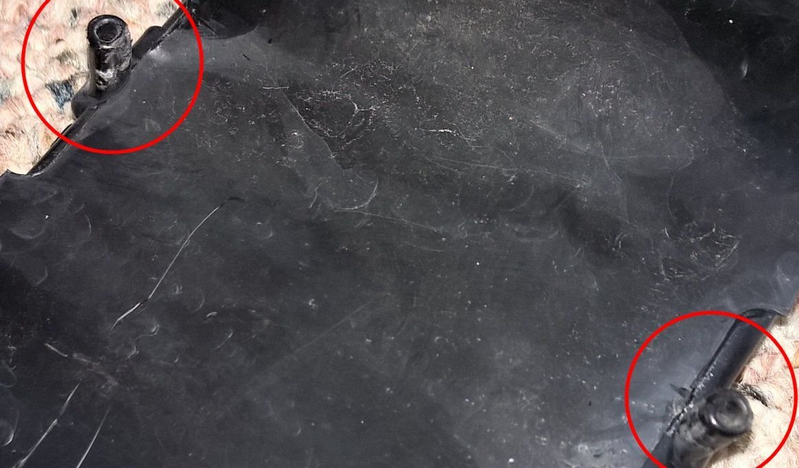

Then you must pry off 12 washer type fittings ( I used a very very small blade common screw driver ), one from each stud of the grill panel from the back side of the bumper ( see image showing two studs outlined by red circles ). These can not be saved as they will get messed up upon removal.
Then you can remove the mesh grill, it will still take some gentle prying with a trim removal tool to get the studs through their openings in the bumper, take your time as it is easy to bend the grill and its frame.

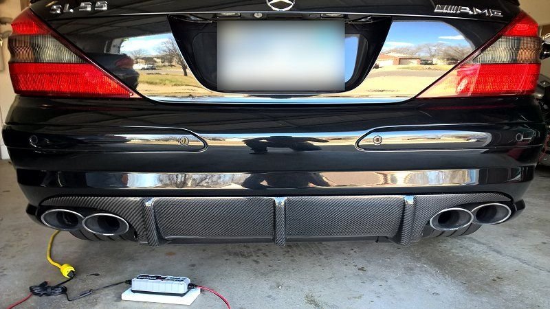

I then dropped the exhaust including mufflers from the rear couplers ( just behind the secondary cats ), there is a cross brace which must be removed in order to separate the two half's of the exhaust in order to remove.
I had to perform an extensive amount of modification to the diffuser ( cutting, grinding, filing, and sanding ) as I did not want to modify or cut my rear bumper, so I can put it back to a factory look if desired.
It took a lot of time to get the diffuser to fit flush with the bumper and look factory.
The diffuser is attached with stainless steel bolts, washers and nylon insert lock nuts.
I was able to utilize the exhaust tips and under side curves of the diffuser and bumper to hide all attachment points.
