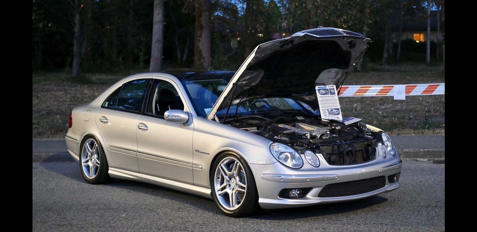

Im looking for a set of these wheels in good shape. Preferably in California but if a deal is good with shipping im open to that as well. I believe these come on r230 sl models. They look like the stock e55 wheels but the width and offsets are different.

according to the owner of that car they are 18s.
Check this video. Says they come on a 07 sl550
