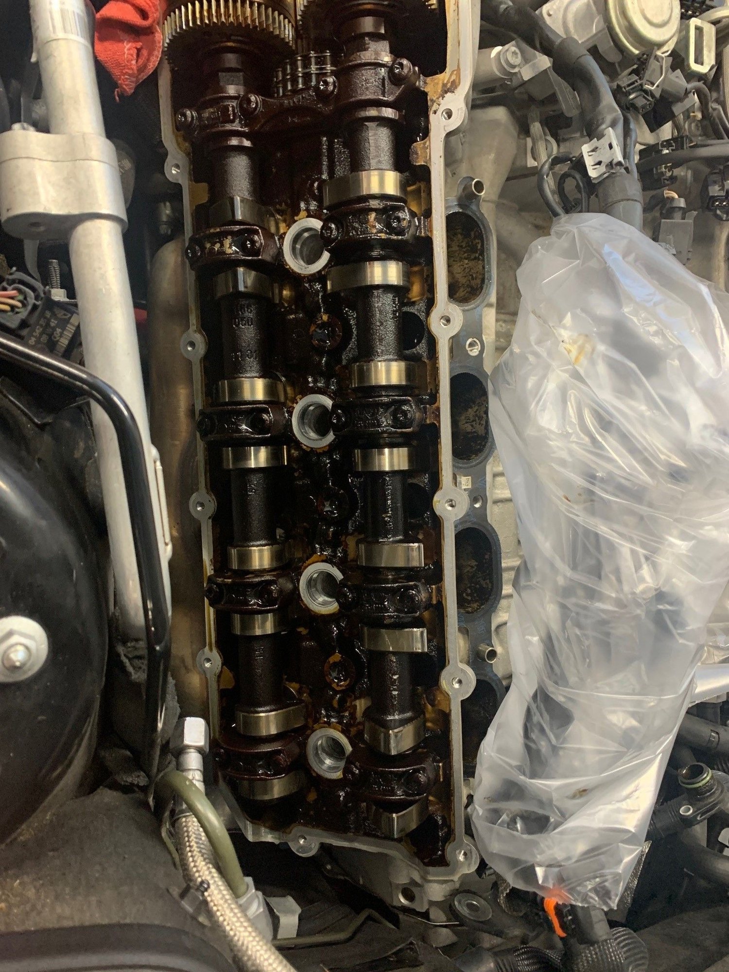

Old Dec 29, 2022 | 03:47 PM
DJAC's Avatar
Joined: Jul 2008
Posts: 29
From: San Diego
r230 sl63, 2002 clk55 Cabrio
When we removed the valve covers the heads lopoked like this. Off came everything followed by a full clean and new buckets. The oil under the covers was contaminated by the leraking bolt. Two bolts stretched and they were a ***** to get out, toook a good mechanis 6 hours to remove them (without damaging the head.
Get it done, mine were at about 67,000 miles also.
