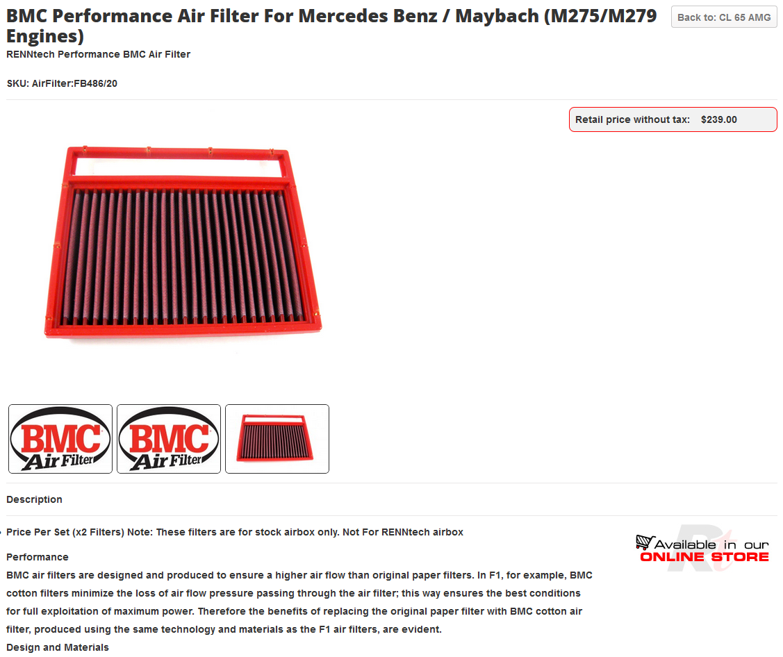

RENNtech intakes come with BMC filters for the most part.
Below is the part number on both BMC's and RENNtech's website.
What's interesting is the comment on RENNtech's site that the BMC filter set doesn't fit their intake, which is unusual given that other RENNtech intakes use the factory sizes for their filters.
Do you have photos of your airbox and the Green Filters that are currently on it? Curious to see if it's an obvious different size / style.
