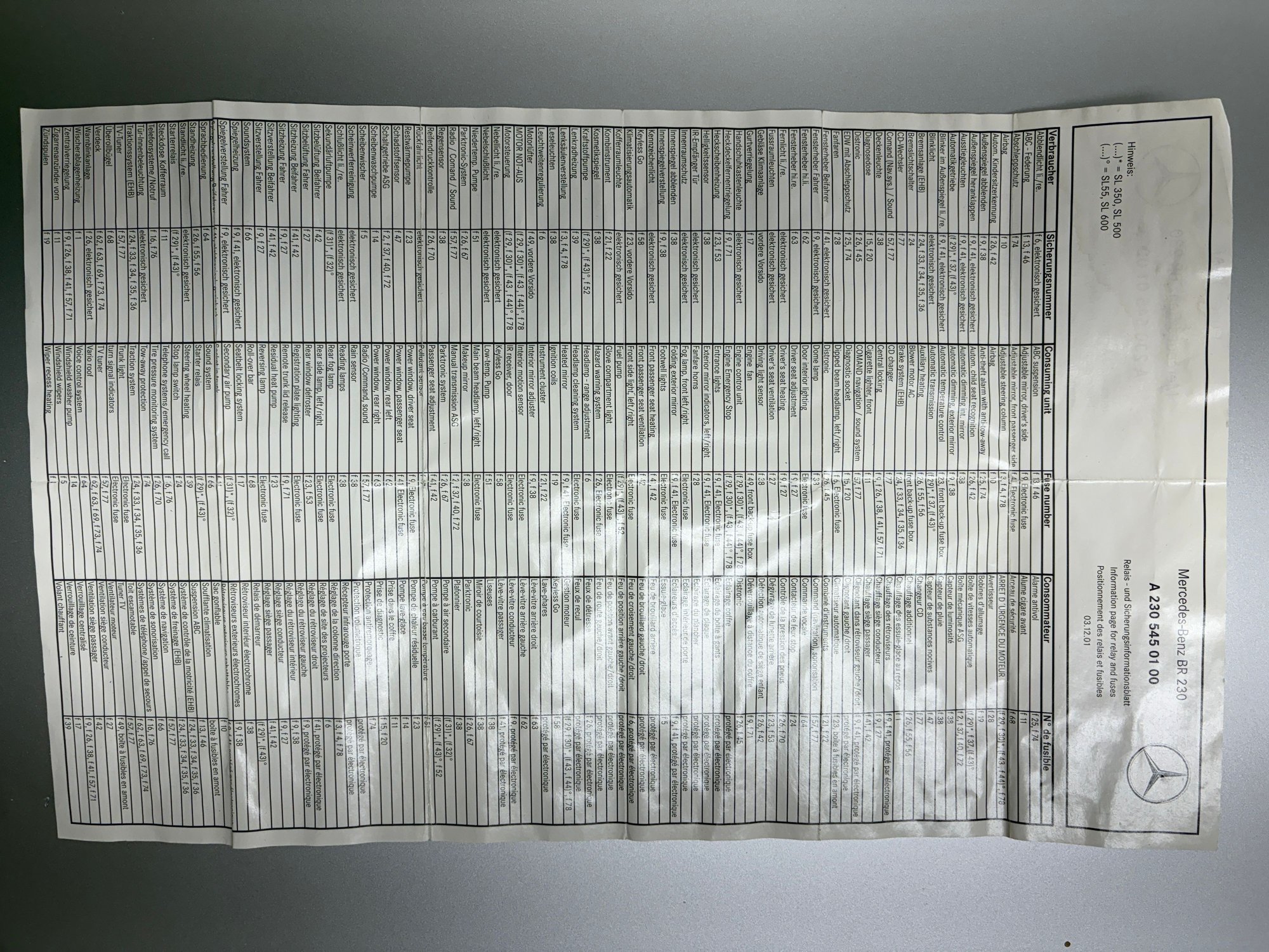

Old Jun 20, 2025 | 11:13 AM
MK19's Avatar
Joined: Mar 2021
Posts: 273
Likes: 21
From: Rocky Mountains, Colorado
Just sold my '11 Porsche TurboS cab for an '03 SL55!
Fuse Chart
My MY '03 SL55 fuse chart says f57, f77 see attachments and let us know what you learn.
