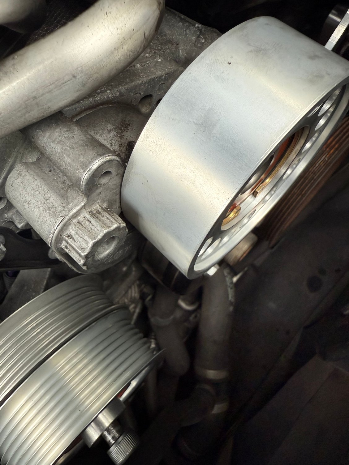

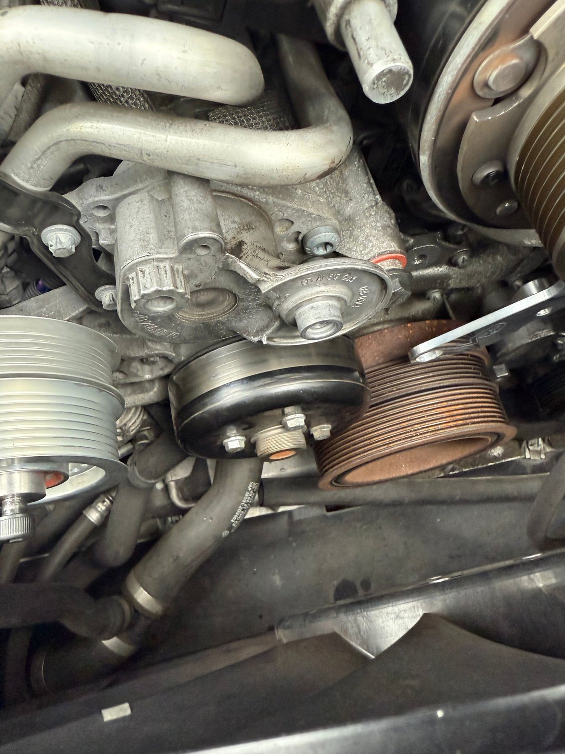

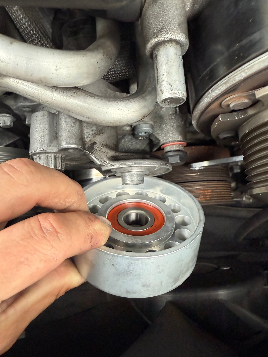

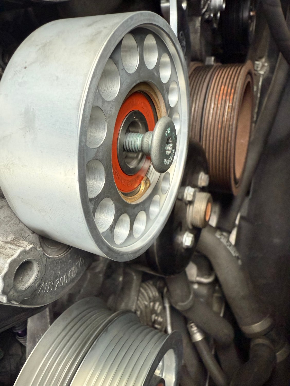

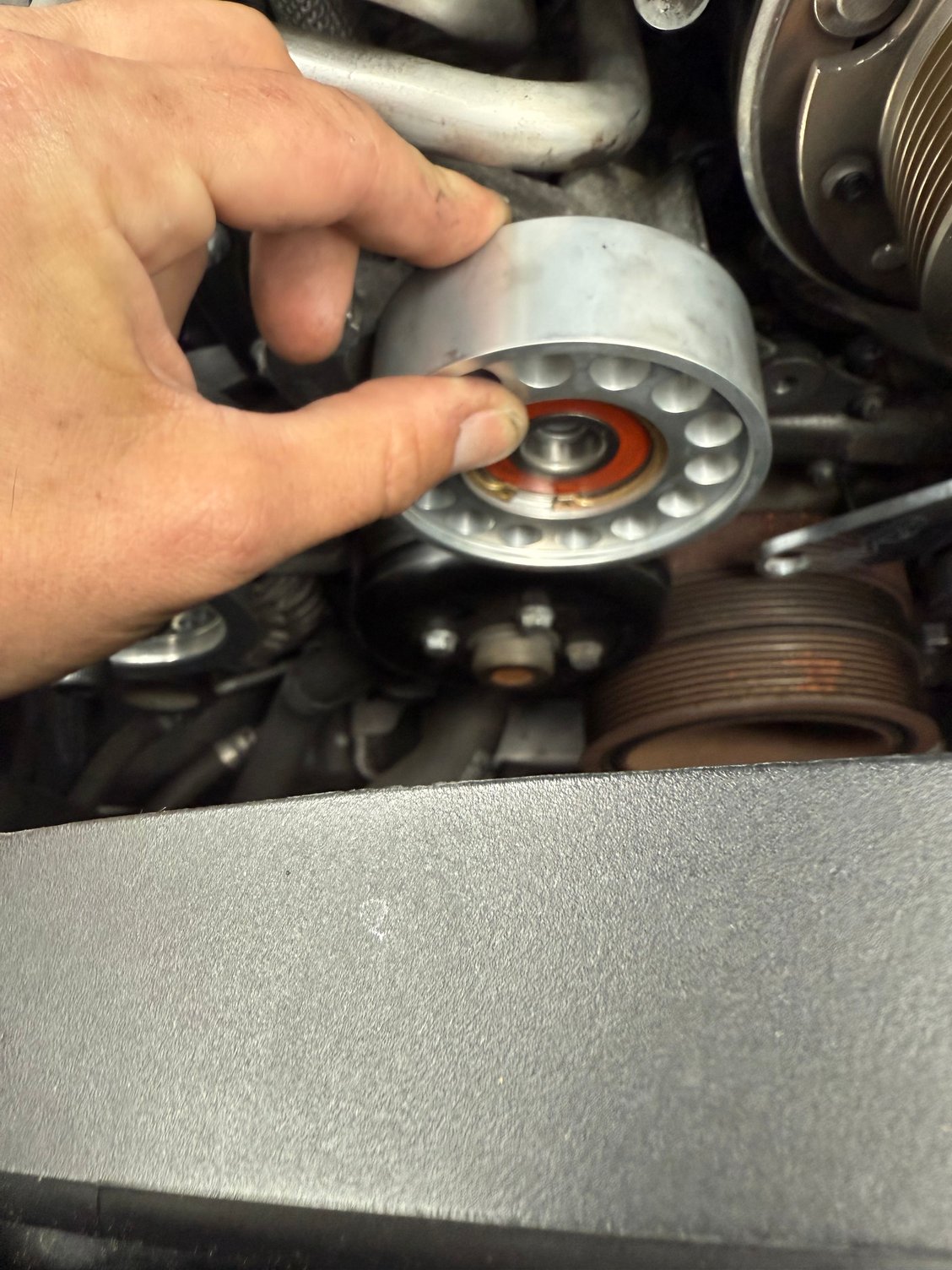

I feel like a fool right now. I really question if Cody at VRP has ever installed one of these kits, he swears up and down this pulley kit requires no hardware and after trying to install the way he told me to install it what I’m getting is binding and there is nothing supporting the front of these bearings ! I may be new to Mercedes tech but I’ve been wrenching my entire life ‘ He supplied no races to go on with the bolt so they just float in the front and the mounting post only supports 30% of the bearing . There is no way that this is quality. This is a joke!! I’m about to pack this entire box back up and return ! I don’t know what’s going on over there at VRP but here are pics someone make it make sense ! I was doing this work for someone else and now feel like I have to purchase a kit else where to make things right which I’m in no position to do ! I have to believe someone else can chime in here

thanks man I solved the SC idler issue with a race from upd and shaved the tensioner skirt down but really upset that I had to do any of that ! I got a voice water pump and just got a low pressure code for abc pump and found the condenser is covered in oil ! its hard to see where its leaking from underneath so im leaning towards pulling the res to get eyes on the pump
