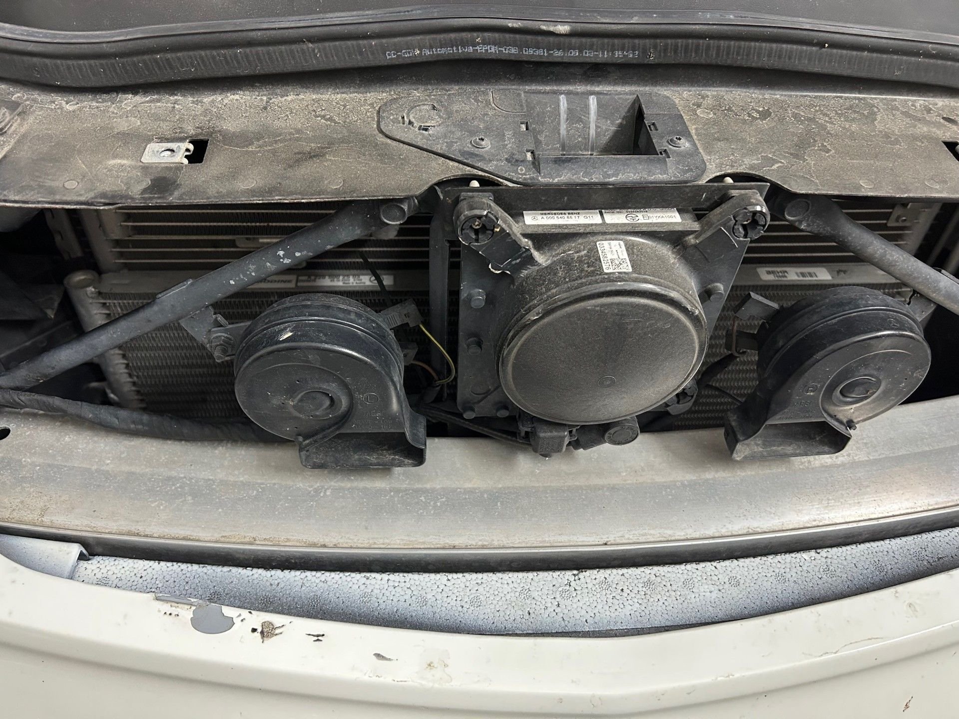

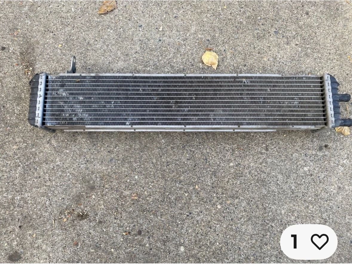

With the grill off I examined the coolers and radiators. The cooler (heat exchanger) for the intercooler is already two-thirds the size of the entire radiator area.
BTW the part number on my cooler appears to match the SL55, SL65 and SL600.

That’s 2/3 the size of your radiator?

Here is a picture of my Intercooler radiator which sits in front of the A/C condenser and Engine radiator. You can see it is full width and about 2/3 tall.
Is is part # A2205002503. I just checked and it is indeed connector to the high volume pump I installed.
