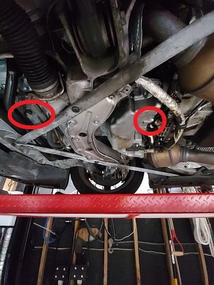

Are these the two oil drain plugs on a 2004 SL55 AMG?
THANKS!
