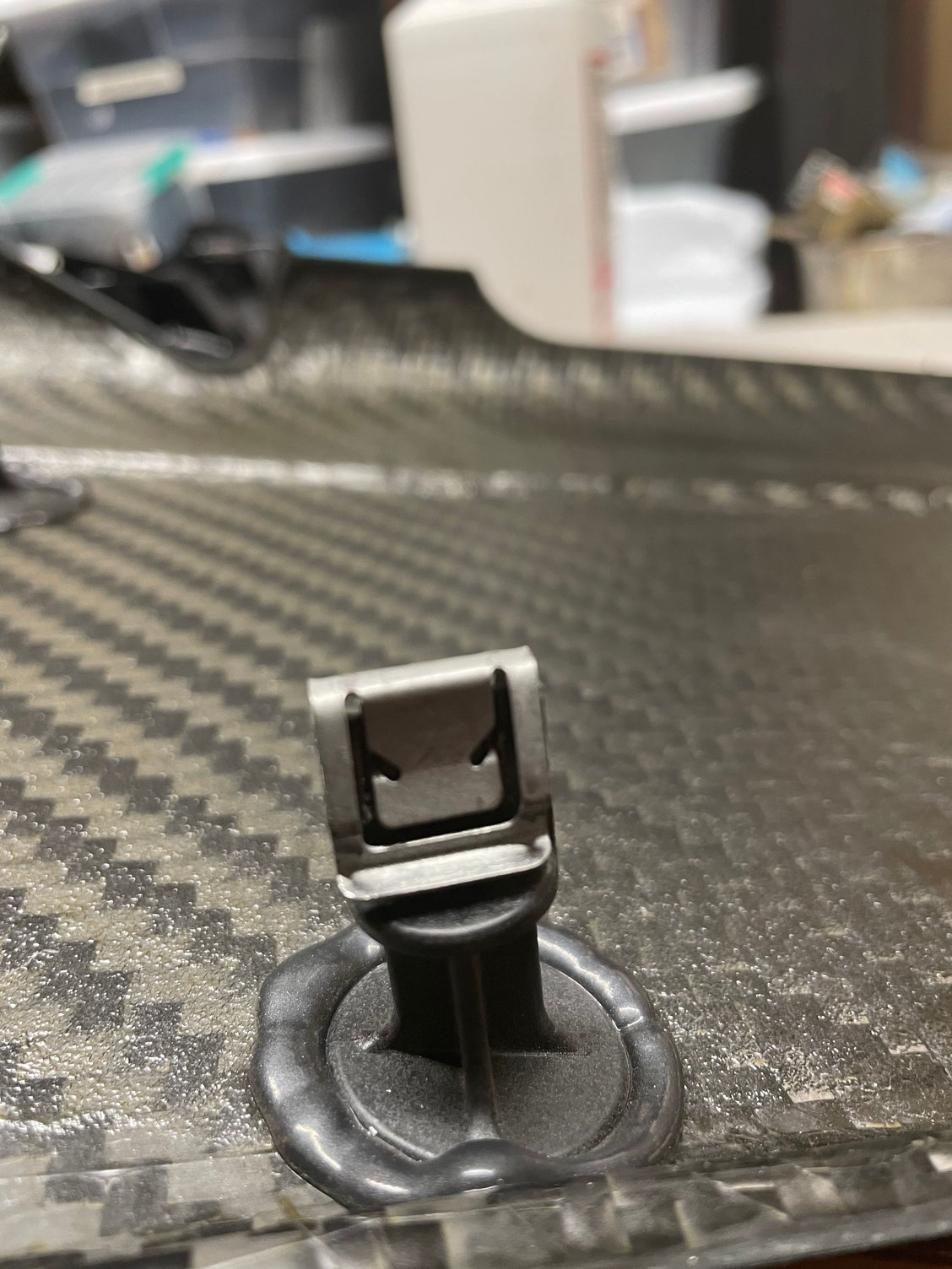

If you have missing carbon fiber engine cover clips, here’s your MB replacement part number.
(It’s likely they are all the same for all MB with this style of clip.)
Make sure you find your old clips if you “lost them in the engine bay on removal.

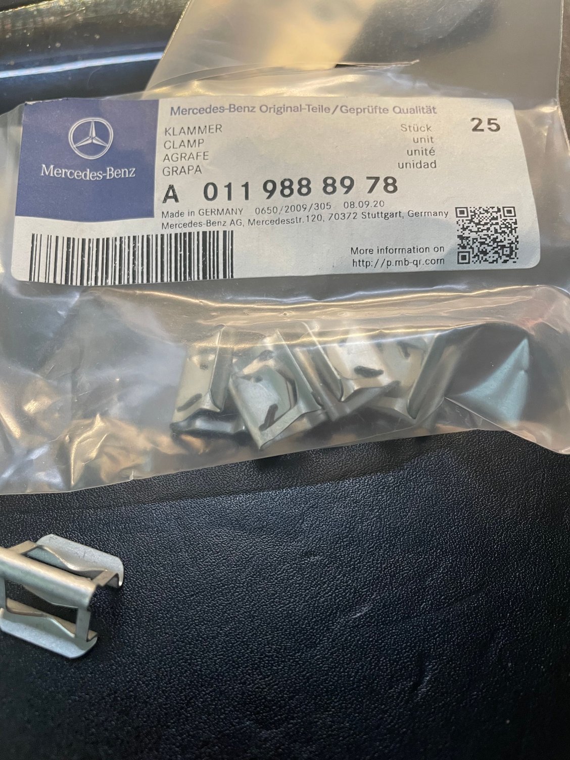

MB does sell them but as a body part (rocker clips). It makes sense since they don’t have to tool up special clips. It’s just that the dealers’ parts system is not broken down to the level 2 component part level, so someone has to dig out the part number, and the dealer can’t order it.
A 011 988 89 78 “Clamp”.
Price range: US$1.75 to US$5.69 each
Carbon fiber Engine cover
MB Rocker Clamp: A 011 988 89 78

theres 2 different kind also, but if thats the right one, your number is right
