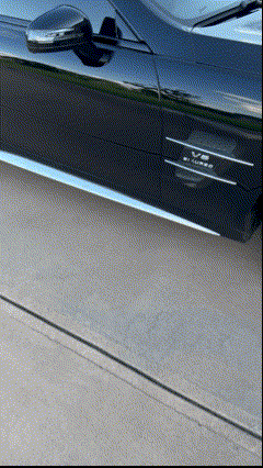

Incredible amount of brake dust after just a week of not very hard driving - maybe 200 miles total.
This car generates the most brake dust of any vehicle that I've ever owned. Makes one wonder if the CCB wasn't a worthy upgrade.

Just get ceramic pads and ceramic coat the wheels. Huge difference.

its the brembo pads. get different pads

Check out EBC pads. I use them on my SL63 and they made a huge difference in the amount of dust.
