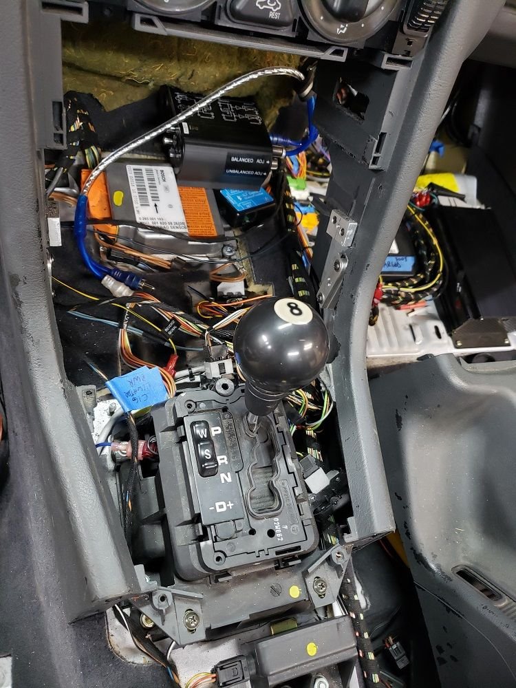

If you look at the 2 pictures that I took during some upgrades in 2020 (particularly the lower console sitting un-installed off to the right in the first pic), you can see how poorly it started and how nicely it finished (using the terry cloth method).
notice how bad the paint was on the removed lower console section
impossible to see where the paint had been missing now
