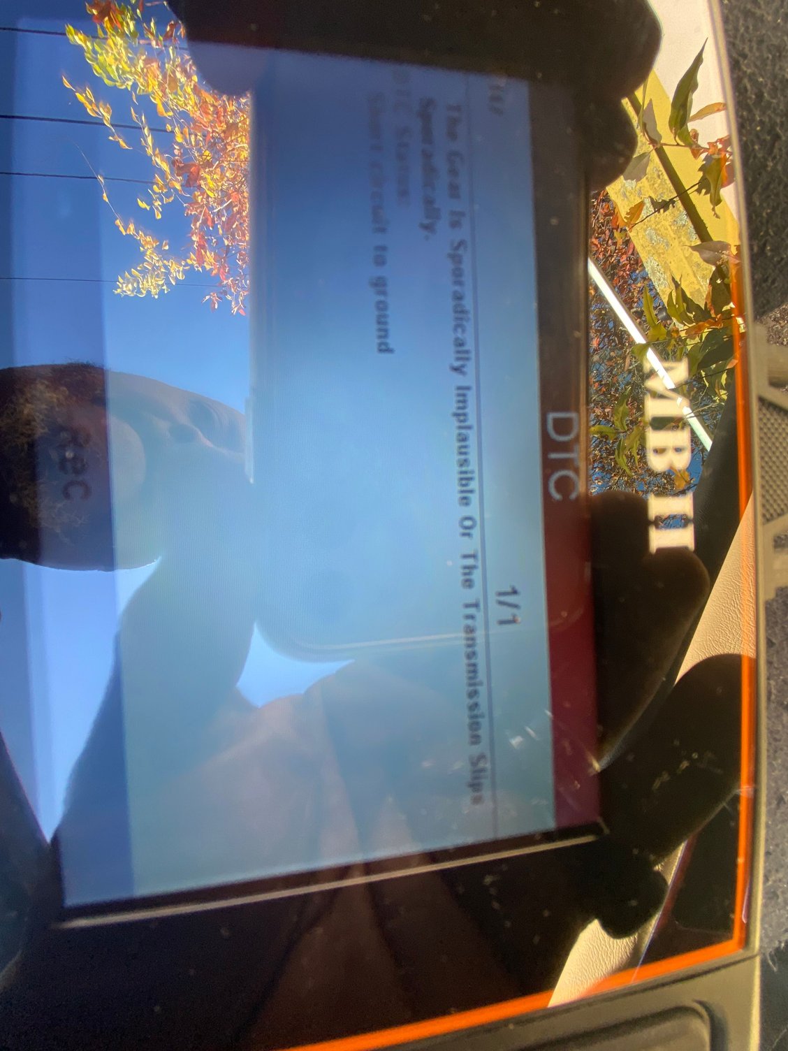

R 170 Slk320 DTC code 147
I’m pretty sure this has been closed I just want to make sure that I’m posting to the correct area, I have recently swapped out the gear selector because of a limp mode issue, the car ran great and passed vehicle inspection after the swap my blinkers stopped working as well as the hazard lights. And then I noticed the the car would shift through the gears fine until I came to a complete stop and the she slips right back into a limp mode but I get stuck in drive or 3rd gear,so I ran a scan and have come up with this code and can’t track it down.
