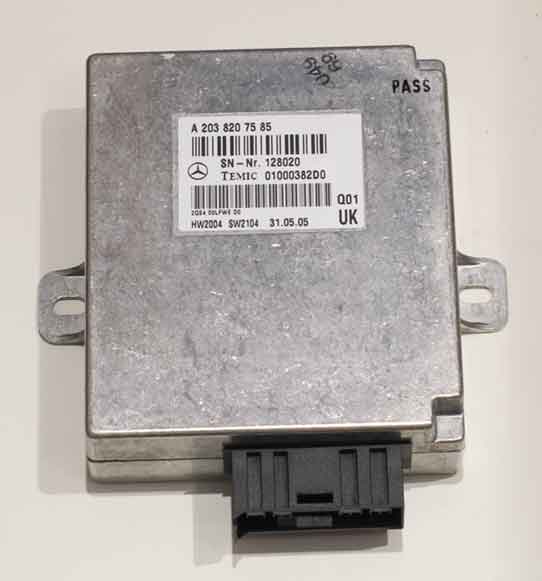

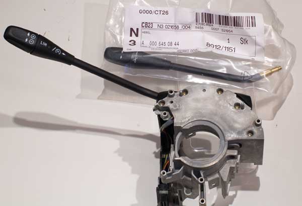

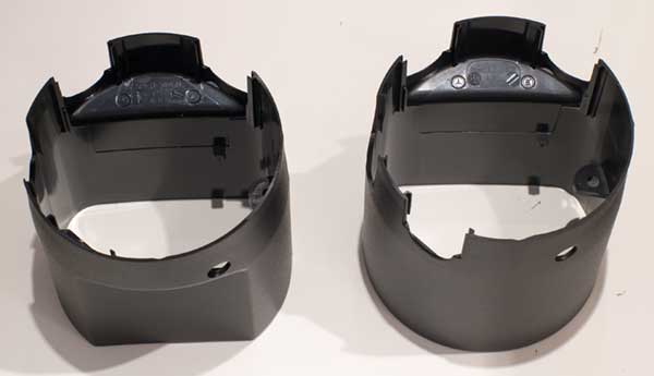

After ordering some parts from Steve I realised that the CLS (W219) steering column is made from SLK (R171) parts.
As the switch and steering housing are both SLK parts then this confirms that the option is possible on SLK with adequate combinations of parts as used in the CLS. It is however speculation only at this stage as I have not completed any transformation of an SLK into a Linguatronic capable car.
Will report back once I see one operating in Australia. BE AWARE that Australian compatible part numbers may be totally useless in the USA. For kits please contact MBENZNL (Steve)
In order below -
Steering cover without memory and with memory
Control switch with Voice control and speed limiter
UK control module
