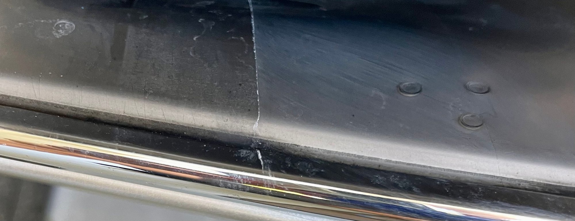

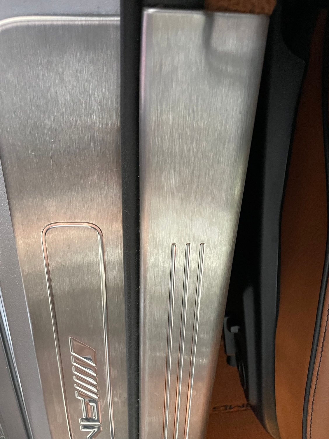

If you have the aluminum sill covers they will tarnish over time. They are not coated and easy to hand polish in minutes. I do it around every two years.
before
after

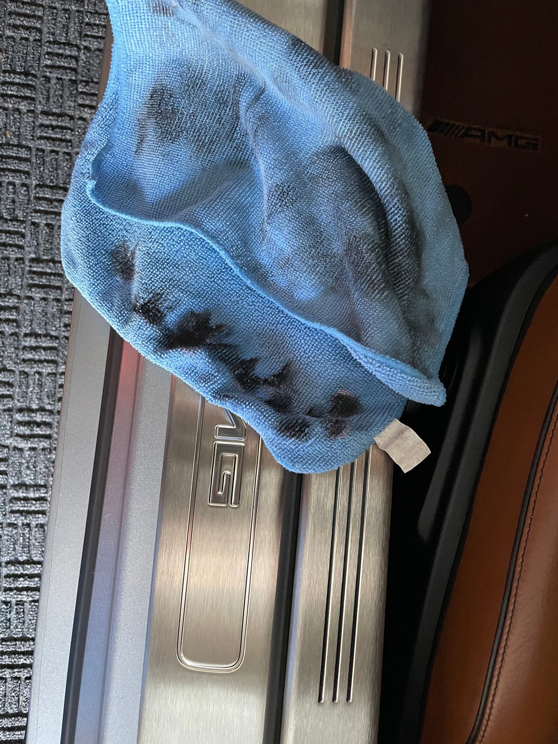

I have this and it must be 12 years old ..still works like a champ. Im sure any aluminum polish will do.
works great the exhaust tips too
right side of photo is clean side
PS do not use on the “fins” on the hood and side sills. Those are plastic.
