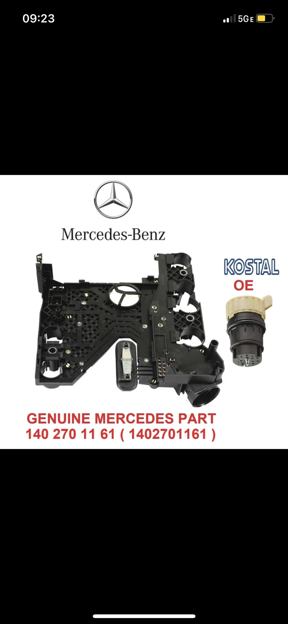

Jul 22, 2023 | 09:28 AM
Transmission
Sounds like it could be a Conductor Plate issue or low transmission fluid level. My S65 AMG transmission went crazy, I replaced the conductor plate and it was a new car! Hope this helps.
