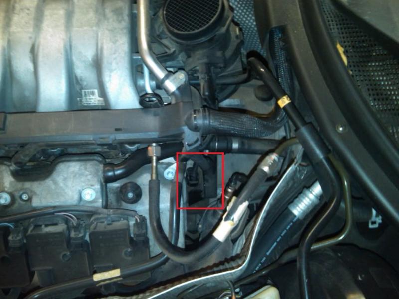

does anyone know where the crank position censor is located at ? what do I need to replace it ?

located on driver side, (US) extremely close to firewall. Can't remember the torx size to remove it but it took me a long while and lots of patience to remove it. You will need long extension for your ratchet. Good luck.
http://www.benzworld.org/forums/w203...r-cps-diy.html
