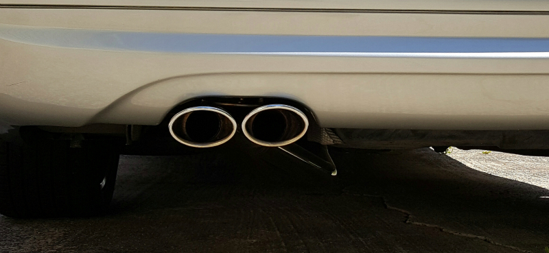

Muffler Delete
I was satisfied with the exhaust note after I had my resonator removed, x-pipe and headers installed some time ago. Over time, I got used to the sound and it became normal, so I decided to remove the OE muffler, in lieu of purchasing an expensive aftermarket muffler. I had a fabricator make up the muffler replacement so that it attaches exactly as the stock muffler does. So I can switch the straight pipes with the muffler myself in 30 minutes or so. I also purchased a new set of aftermarket tips to make the new piece appear as stock as possible. The ovals are slightly larger, but close enough for me.
It is loud, as I wanted and expected. It sort of sounds like a high performance sixties muscle car without the syncopated, big cam, rhythm. At idle and cruising speeds it isn't too offensive, but when you get into the throttle, it really rumbles. It isn't a daily driver and I can always switch systems if I wanted to use it for a long trip, etc. Right now, I dont see me changing it anytime soon.

I like the sound. Maybe I'll do that instead of looking for the eisenmann and paying crazy money for it. If you don't mind me asking, how much does it cost? Can your fabricator make more? text me 860 620-2927

Yes, the Eisenmann was way too much for me, especially since you're getting basically the same thing with their race version. It wasn't inexpensive at $725 + the cost of the tips that I provided. But you're not getting the quality stainless and super nice welds at a bargain price. It took a lot of time to put it together. I'm sure competent muffler shops can do it a lot cheaper, but I don't know of any. I was adamant about it lining up nicely and having the correct reveal of the AMG on the tips when standing behind the car. The fabricator mocked it up on my car as a one-off piece. I'm sure he could make more, but he didn't make any fixtures that would allow him to make more without having a car there to work with. When I picked up my car, he was working on a side-exiting exhaust on a 700+ RW HP G63. He said he was making fixtures so he could make more as needed. With the age and minimal examples of our cars out there I don't they will feel it is worth their time to make the needed fixtures to easily replicate the system.
I forgot to mention in my original post that in addition to the weight savings from removing the heavy OE muffler, the straight pipes wake the motor up, big time. I'm not talking about sound, but power. The butt dyno detects a nice improvement!

That sounds great! I'm looking to have my Y-pipe/resonator (wagon exhaust is dual to the resonator, and a large single inlet to the muffler) replaced with a custom Y-pipe, hoping for that tone, but quieter.

I wish I had a welder like that where I live. Maybe there is but I never come across yet. That is some good welding. Very study hands for sure to produce that unified small weld. The price is not bad, talking about brand new stainless steel custom pipes. What size are they...2.5" or 3". Hard to find good workmanship nowadays especially the younger generation. I like the tips too. Very low key I guess the sound gives it away

Thanks, IanB! So your custom Y-pipe will eliminate the resonator? If so that should definately help. Ideally I wouldn't mind my system being a bit quieter. It is difficult to achieve the desired tone and decibel levels. When I had my pipes built, I talked to the fabricator by adding an aftermarket muffler if I found the straight pipes too loud. Thus far I'm loving it and have no current plans to change it. I can see (hear) how it can be too much for some!
I agree with you, the craftsmanship is top notch. In a way, I hate that those welds aren't somehow visible. If you stand (or drive) far enough behind the car you can see the shiny stainless pipes where they turn and drop down before extending to the back of the car. They are 2.5".
Yes, the OEM resonator acts as a Y-pipe on the wagon, and I'd be retaining the OEM muffler, which is very large and runs the width of the car tucked behind the rear bumper. I'm hoping it nets me a nice rumble and tone, without drone on the highway or being too obnoxious, lol.

Prior to the muffler delete I replaced the secondary cats with 200 cell cats and replaced the resonator with an x-pipe. It has been a year now and I love this setup more than ever. No thoughts at all of installing the OE muffler.
