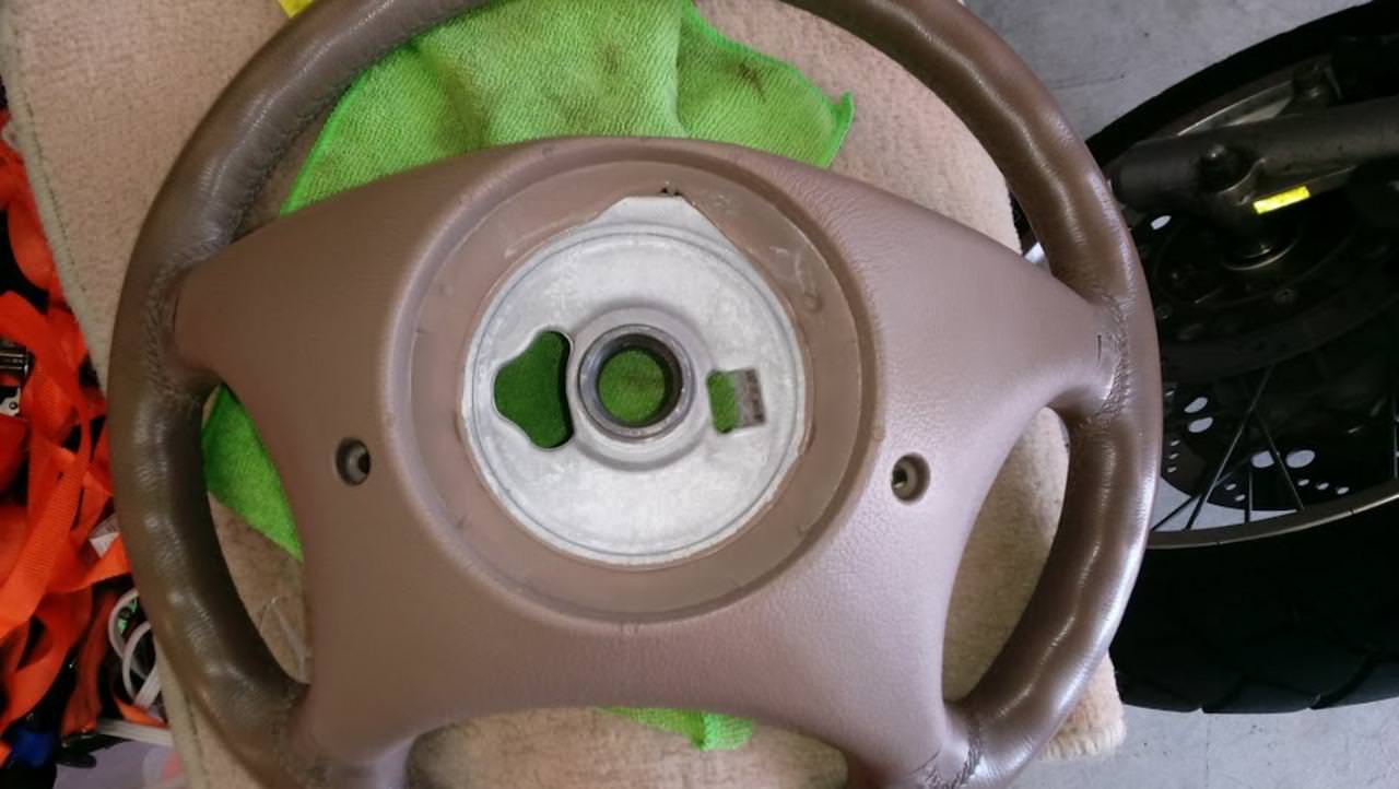

I'm pretty sure that the CLK wheels are the same. Here are some pics the steering wheel that came off my W210 E320 wagon. I swapped it out for a W210 E55 steering wheel, which bolted right on.
Back of steering wheel:

Well it fit perfectly. Such a big difference having a nice steering wheel. It arrived about 25 minutes ago and I put it on. Would have been faster but one of the airbag bolts was totally stripped and I had to cut through the steering wheel and cut the bolt off but asides from that it was super easy. Thanks again.
