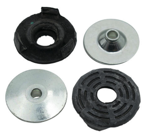

No - I replaced BOTH the front diff mount (2 rubber plates) AND the transmission mount/carrier = rubber in metall composure, fixated by 2+2 bolts Unfortuneatly it didn`t solve the problem..
As I mentioned before I also replaced the motor mounts and the whole driveshaft incl. a new center bearing + checked all angles according to the official tolerances from MB..

Now 2 new subframe bushing + new AMG transmission mount
Originally Posted by Tall Giraffe
I think your first post has it being the front bearings at your mileage. I have replaced front bearings and the rear bushings set in the last 2 months along with everything in your list aside from accumulators and diff mount, granted Im over 200K miles. I also bought new shocks and springs, aligned, control arms. tie rods, sway bar bush links etc . My problem finally showed after replacing my bearings and it is a bent front right wheel. Mine is a 65 to 75 shimmy but it doesn't quite go away at higher speeds. Once my new wheels arrive, Ill be able to determine if the chase continues.
My front bearings had play over imperfect roads and 12 and 6 pm so at my mileage replace was the direction. My spindle started to show wear from the loose bearings wear. I have the new ones tightened to .013 mm play on both sides. After that, the wheel vibration really came out. Thats when I went to rebalance and was told about my bent wheel. Still the car felt more solid /responsive/smooth ride up to 60mph so I look forward to new tires and wheels.
While I realize our cars age, Im not certain the rear bushings would be in that bad of shape to cause your issue at your mileage. Also that is definitely a rear drive line shimmy if they are bad.
Another clunking sound culprit in the rear is the control arm outer bushing. Those you feel over speed bumps in rear.
Id look to the bearing tightening procedure first before tacking the subframe bushings. Still examine the subframes cause you never know!
I replaced and installed 2 new subframe bushings (front ones) and additionally replaced the transmission mount with an AMG upgrade version. I set back the former 4mm shimmy due the new bushings.
Unfortunately I still have minor bodyvibration and kind of little rough rolling + rolling noise - I guess from the tires (from 65- 80 km/h)....compared with the smooth floating up to 60km/h and from 120km/h upwards.
I also checked all 4 wheelbearings for play (12/6 and 9/3) - but no play..
Control arms. tie rods, sway bar bush links seems to be fine - no play. The car has now 120.000km on the clock - is it reallly possible that one of the wheelbearings is broken ?
I wonder where the error now might be..

After I got 4 new tires - these finally were not the left out reason in my case.
I now found out -
that the 16 bolts on the flex discs of my driveshaft have 2 different types of washers (with different diameter..) which I did not recognized when I installed the new propellshaft - so they where mixed..
My next mistake was that I afterwards installed the bigger washers on the front disc and the smaller ones on the rear disc - and the vibration became worse...:/
These bolts are hexagonal bolts -
I assume I have to put the bigger washer each time on the opposite side of bolts which are in contact with the flansh in order to balance the center of the bolt`s position in the flex disc? (big hexal bolt head + flansh on one side in combination with bolts on the disc sticking out more on the backside possibly need 2 sets of different washers in order to balance the disc..) So the smaller ones on bolts mounted direct on the discs - where the flansh is on the backside.
But as I am not sure - and haven`t found anything about this wired bolt-washer set on the internet - I now ordered 2 new flex discs with 16 bolts (torx) incl. just one type of washers.
I hope that finally will be the solution - I report again when this is installed. As everything else from pinion angles and other potential components has been checked out.
