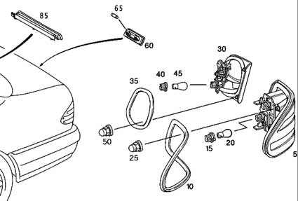

Im Searching for Pictures and Part Numbers for the Tail Lights, W210, Bj2000, USA-Modell (red/white), whit includes sidemakers.

030
A 210 820 41 64 TRUNK LID, LEFT CODE: 494
A 210 820 89 64 TRUNK LID, LEFT CODE: 494+954
A 210 820 42 64 TRUNK LID, RIGHT CODE: 494
A 210 820 90 64 TRUNK LID, RIGHT CODE: 494+954
494 = USA , 954 = Avantgarde
005
A 210 820 35 64 LEFT REAR FENDER CODE: 494
A 210 820 83 64 LEFT REAR FENDER CODE: 494+954
A 210 820 36 64 RIGHT REAR FENDER CODE: 494
A 210 820 84 64 RIGHT REAR FENDER CODE: 494+954
Attached Thumbnails Search W210 TailLight Pictures and PartNumbers-rear-light-w210-99-.jpg
