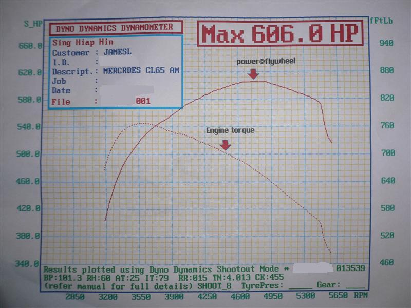

Mine, done around noon time of 36c. Not sure of elevation. Very hot and humid day.
Sorry guys i had to ink out some of my car private details.

James,
That is amazing power. You must have an ecu upgrade based on the numbers, would that be correct? Also, did they provide you with an air-to-fuel graph?
Thanks for sharing,
Darren

No Darren, you've mistaken, my car is a CL65! Not E55. Thats why those figures. The car is bone stock. I just broke her in at 1100miles and brought her to get dynoed lol!

James,
I know it's a CL65 based on the graph (and your profile). I just thought the numbers where a little higher than a normal 65 series. There's no way a 55 (E, S, SL, or CL) would make that much power with a ecu, much less a pulley and headers.
Congrats on the new car
Cheers,
Darren

I am begging you to get the ECU mod.....Kleemann says it instantly bumps you to 730hp. HO-LEE-CRAP. You will be a pavement torching monster.
Wow, I wonder what you would run with near 1000ft lbs of torque.....besides off the road.....heh heh. Think Trey has it and runs near 11 flat.
Stage 1 Before
612
1.000
After 739
1.300

how did they determine the crank numbers (15%,20% or some other?)
