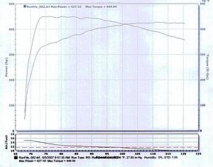

Did a dyno on my stock '04 E55 w/ 38K. Results are posted below. I think the numbers are pretty good for stock. I was curious if the Air/Fuel is good and if adding an ASP pully alone was safe.
Once the pully is on, I will let the ECU adopt and will do another Dyno for review.
Also, first pull was good. The rest of the pulls the car down shifted at WOT . Pulls were made in Dyno Mode in M4. Any tips for the pulls?

That can't be right with 445 rwhp (stock) when the factory rated at 469 at the crank. Just only 5% lost throught drivetrain?
it say 427 max HP and 449 tq
my car was only 401hp but there were other members here sayin they had 420 in the Hp?
We go neck and neck I had 410 stock...
Very nice numbers for a stock car, healthy!!!

Air/Fuel is kind a rich no ?

is that SAE or STD?

Originally Posted by Fikse
is that SAE or STD?
The correction displayed is STD, that means the car made about 391.83 uncorrected. Which considering the barometric pressure is quite good imho.
Aren't they all stock? At least what I heard... that's why some people think that a pulley would be ok without ECU tune.

The graph looks good to me. Strong car.
Next time, have them display HP vs RPM instead of MPH.
Yeah... didn't catch that till later... weird that they would do that.
What is the bottom scale? When I've run on a dyno the wheel speed is close to 200mph. Was the pull done in 4th gear?

No... you're not missing anything. Those mph numbers don't mean anything (I think), since at the end of the pull I could have sworn the needle was almost at 160
I wonder if I can have them replot that run on the RPM range with their comp... not sure if that's doable after a run though...
Yeah, it can be replotted with just about any thing that was measured from the car.

My main concern with your graph would be how AFR drops off up top. Below 10:1 is exceedingly rich, and judging from the way the graph is headed makes me think that you possibly didn't have enough adequate airflow (which is no surprise as most dyno facilities can't produce the airflow).
Also keep in mind that dynojets are generally not loaded, meaning that the load would not be an accurate indication of what your car is doing on the street.
Nice graph though, I think I'm going to strap my car down in the next few days see what it does on a loaded dyno.
Most bone stock dyno graphs I have seen show the same plummeting AFR's, including mine.
I have asked this question before, but received no answer - What is the proper gear to use for a dyno run in a bone stock E55? All of my runs were in 3rd because I had read that doing a pull in 4th (the ideal 1:1 gear) will not allow the car to pull to redline because of the speed limiter.
Assuming that it is possible to run in 4th, is my 419 rwhp and 455 rwtq (measured in 3rd gear) less than what it would have shown had I run the car in 4th?
