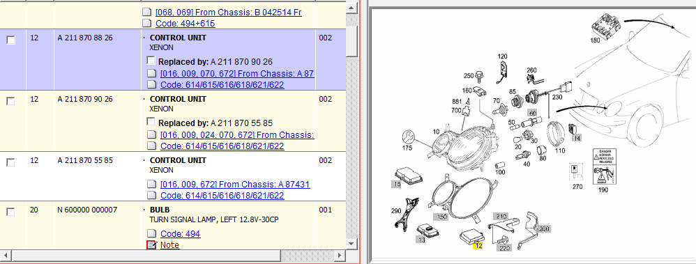

It doesn't -- it's just the ballast alone. The bulb is a separate part #. From EPC:
The dealer told me I needed A 211 870 55 85 (previously known as A 211 870 90 26 and A 211 870 88 26.)

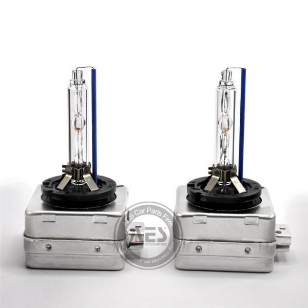

D1S bulbs with igniters..$32.00 per set on Flea bay
This is the bulb holder you need to transfer from your stock bulb over to the new one.
The Ballasts/control units is located under the headlight assy as shown in the diagram above.
