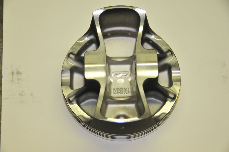

Here's a bit of an update on the E55 motor situation:
I sent the ECU off to Cory at Kleemann and he confirmed that the computer had indeed been tampered with. He said that the tune on it presently was completely stock, but that it had a quick-disconnect chip socket on it and was in fact tampered with. This means that some crappy Merc tuner out there had their dick-beaters all over it, hurt the engine, then sold it to auction only to be picked up by a stealership in Chicago and my dumbass to then buy it. Live and learn I guess.
Anyway, MAD PROPS to Cory at Kleemann for helping me out. They are top notch!

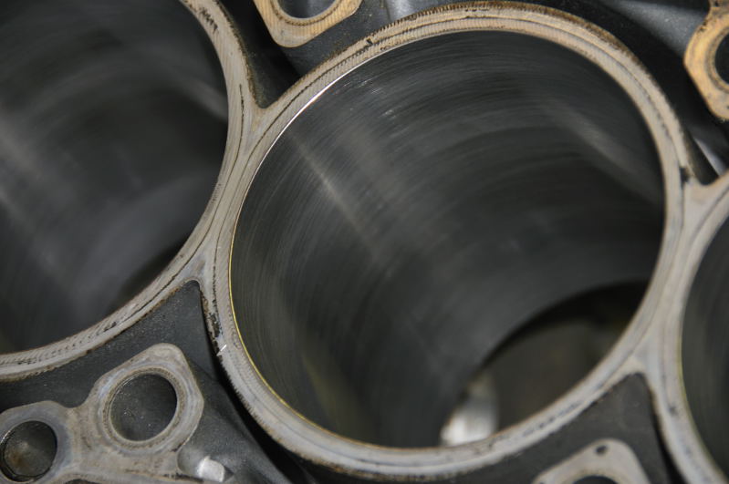

I sent the block to Millennium Technologies to have them look at it. They do Nikasil coating as well as a lot of work with Alusil bores so I felt they were a good shop to be doing the work. I was originally going to have them Nikasil coat it, but decided to bore it 0.040" over and stick with the stock bore material. They contracted with CP to get pistons made. It took FOREVER to get them back, but they finally arrived.

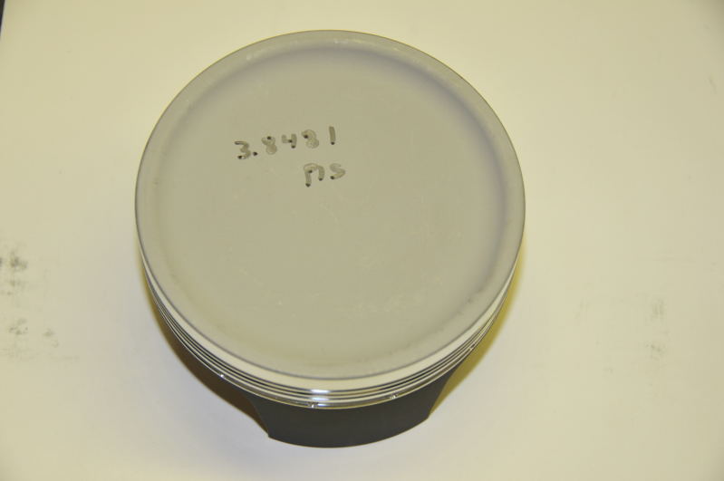

The pistons were then shipped to Swain Tech to have the domes ceramic coated and the skirts coated with something which vibed well with the Alusil bores:

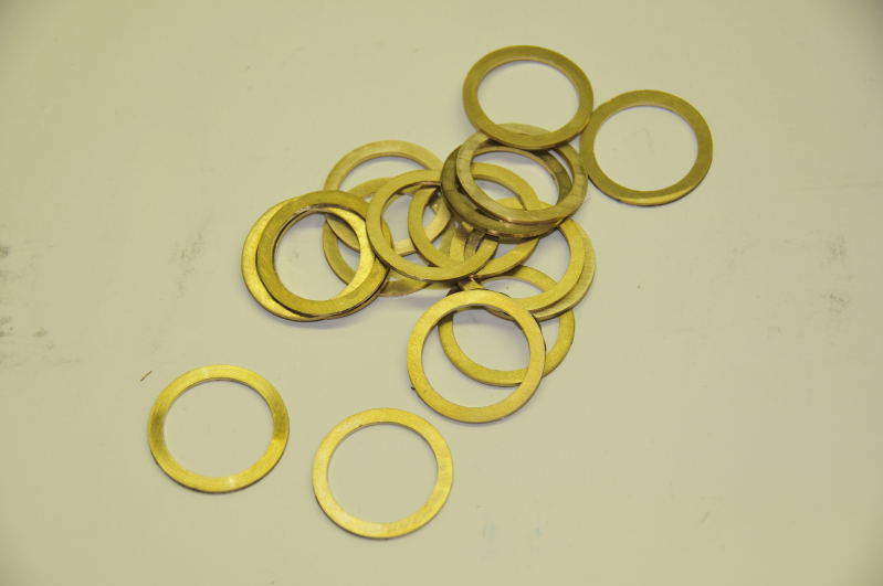

None of the mainstream piston manufacturers made top-guided forgings so custom shims were then made. I don't remember what they said they were made out of, but they look like bronze...but they aren't. They said they'll outlast the engine so there's no issue running them. The stock pistons have a 0.003" tolerance on the top end, so these shims were needed to make up the difference between the wide piston forging and the connecting rod top end.
Here's the block all cleaned up and looking like a million bucks again:
The block is now at the engine shop getting the rotating assembly put together. I'll put the heads on, timing chain, and all the drive accessories when it returns.
Hope to get this puppy back on the road within the next couple weeks!!

Awesome! Since CP now has the specs, can they make another set of these? Did you change the c/r?

I'm sure they can make another set. The shims were not made by them though. Millennium made those in house.
The pistons were made to the same spec as the stockers, but since the bore size increased, the compression ratio was raised a wee bit. Cory compensated for this with the custom Kleemann tune.

I am amazed the head di not see the same pitting as the piston crowns - lets hope they are OK. Wonder if the motor did not have a sparkeplug piece break off in it. Seems suitable type of thing to cause the crown piston damage and mbe a piece got shoved down the sides and crammed the rings up. The S/P metal is pretty soft (electrode part anyway) and that may have been munched without too much damage...
Are all the plugs in the car the same? That might be a clue. Mbe previous owner was too tight to spring for 16 new ones.
Nice pistons btw... what is it with precision machined metal? Can look at it forever.

I bet those pistons were not cheap but sweet! Amazing how they have a fairly low skirt and short profile.

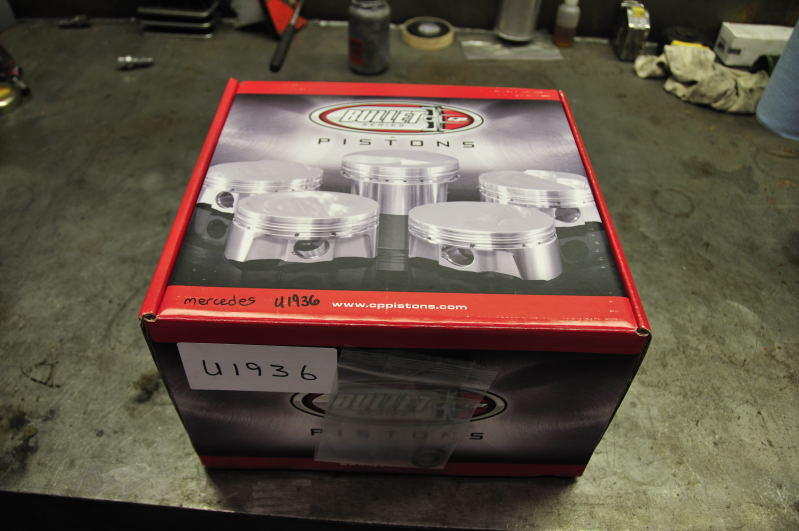

Even with a dealership discount, pistons are $620 a pop from Mercedes...unclear if this even comes with rings or wrist pins. These CP jobbies were about $1800 for the set with coating. Quite the price difference.
As mentioned earlier, the shims go on both sides of the connecting rod top-end with the wrist pin going through the middle. None of the mainstream piston manufacturers have forgings small enough to exclude the use of shims. I checked. The stock AMG pistons are made by Mahle, but good luck getting them to knock out a set for you.
The shims aren't bronze and they aren't copper. I'd be guessing at what they really are since I don't remember. For some reason beryllium bronze/copper comes to mind...but again, this is only a guess. The specific alloy was chosen for this application because of its wear and stress resistant properties. It's meant to withstand the stresses of the engine and the life of it. I can only say that the engineer at Millennium assured me it was a solid fix for the gap issue and has been done many times before with great success.

This is a strange picture as that is NOT what alusil looks like when prepped properly.
