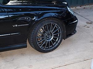

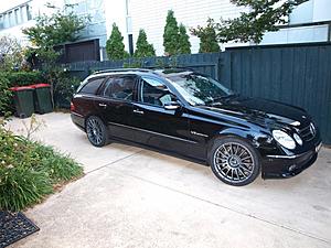

OZ Racing Supertursimo 19" LMs matte graphite ... photos
Ordinary photos, and my wife left it in airmatic 'comfort', but happy with the look. Getting scratches etc cleaned by, will post good shots in 2 weeks.
