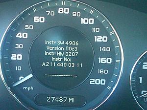

I noticed the check engine light came on today while driving. Only mod I have is a Sprint Booster. Just removed it, as I am taking it to the dealer tomorrow AM. I took a picture of the dash display and am not sure I got the right display. From the temp display, pushed the reset button 3 times quickly. Anyone have any idea's? Is it TPS related, or am I just being a nutbag thinking it could be the Sprint Booster causing a problem?

connect the car to a OBDII scanner and get the fault code. When the CEL is on you cannot reset it through the instrument cluster.

Thanks Shardul. I am set to go to PPMBZ in Dallas tomorrow AM. Was not sure if that was even the correct fault code. Sounds like it's not. Will post the resolution tomorrow.

Ok, went to the dealer on Friday.. Forget the pic above. Has nothing to do with the 'problem'... The reason for the CEL was.... Manifold gaskets... Go figure..codes were 0745 and 2091. Seems to run a bith stronger now.. Also, no more 1/2 second hesitation taht I was feeling before. I am guessing that could be a sign of a vacuum leak. I took out the sprint booster just in case that was causing the CEL (it wasn't), and I noticed the hesitation I felt from zero on was gone. To make sure, I drover it Fri, Sat & Sun.. So... if you have the hesitation, see of the manifold gaskets are leaking...
