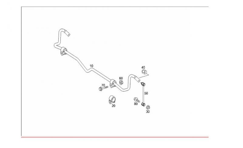

Sounds like the rear torsion bar is loose, this is common on many Mercedes models. This will cause a periodic clunking sound.
Tighten up the bolts with some locktite, should do the trick. (see illustration)
Attached Thumbnails Can't figure out the source of a very loud clunk in the trunk.-e55-rear-tortion-bar.jpg
