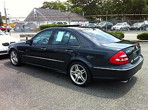

Here's a pic of the car in case anyone might know it. The title says Sayville NY.
