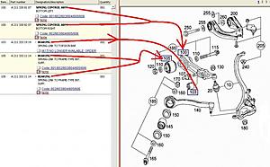

suspension part number
http://i1093.photobucket.com/albums/..._explosion.gif
#13 the larger one
anyone have a part number?
mine has slipped out and is cracked

Hi Eddie,
I believe that part number is 211-333-19-14.
Jorge

Best bet would be to replace the entire lower control arm.

More data
#13 the larger one
Please note the large bushing is NLA.
EPC calls for replacing the arm.
