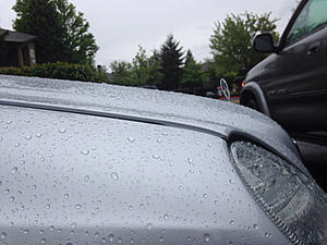

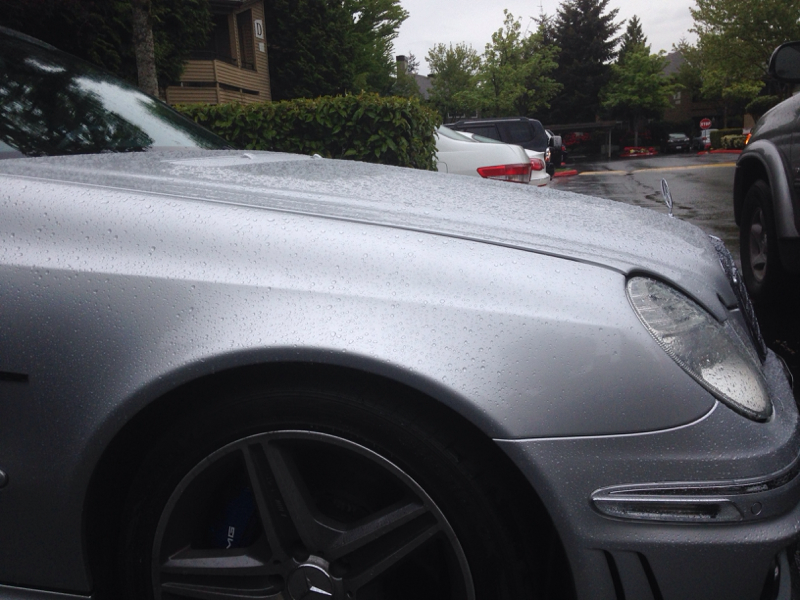

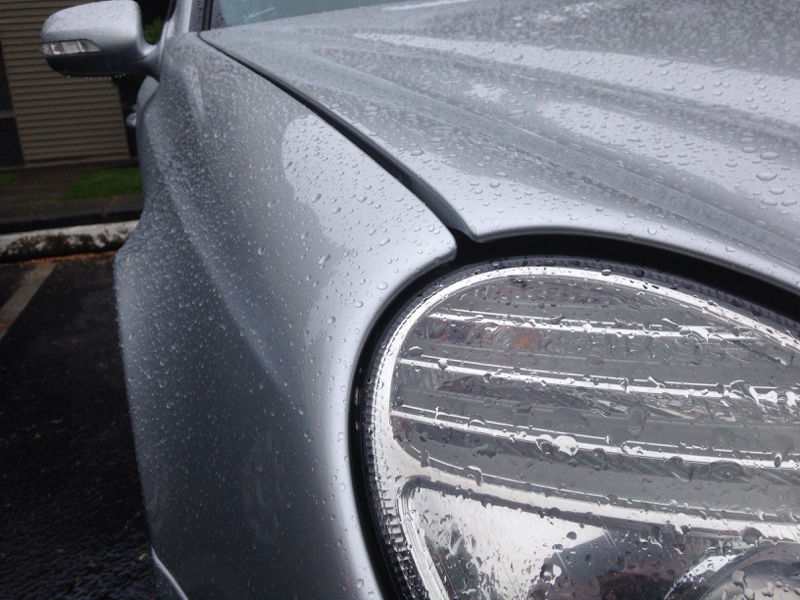

Yesterday I opened my hood to check a few things, after closing it I noticed that the front passenger side corner of the hood is not flush with the fender anymore... Anyone know how to adjust the alignment? Or have any idea why/how this happened?
The car has never been in an accident, so I don't know what the deal is.

My hood was a tiny bit off when I got my car. Look around the front of the engine bay, on the front support beam, there is a forward-pointing bolt on each side with a rubber head that the hood rests on. These can be adjusted pretty easily. I can take a picture later if you need help finding. what im talking about.

I checked all of those, none of them are loose or out of the norm.. I don't understand how or why this would happen randomly.. It looks horrible. Guess I'll be heading to a body shop cause this has to be fixed.

If you press down on the hood at that side, does it move? (btw, I'm assuming that you opened and closed it several times)

Interesting idea, I didn't not try moving it side to side because the drivers side looked perfect... I attempted to move it side to side as you suggests and it worked.. It's not 100% but it look better now... Clearly something is loose.

Check the latch/catch bolts at the very front.
