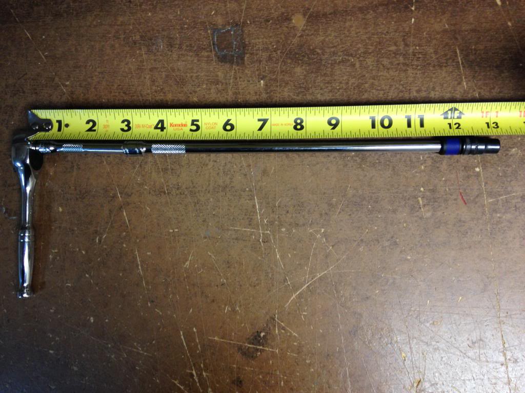

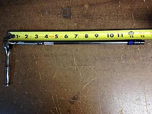

Think this will work ?

I was able to get to mine with a 10" and some odd maneuvering...i would think that will work better as long as you don't hit anything with the handle...

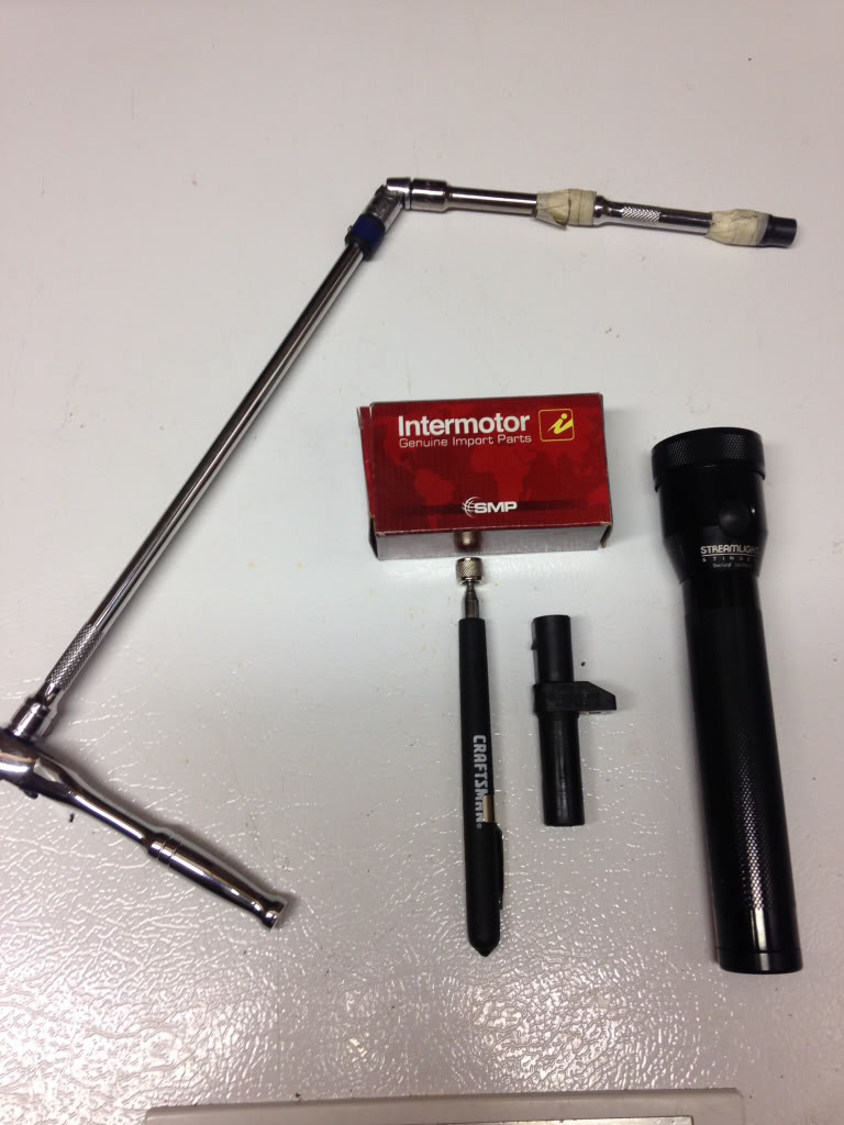

Took about 1 1/2- 2 hours, more time to let the car cool down. A lot of blind touching and feeling and a frankinstein ratchet set up lmao real pain in the A $ $ to be honest
Tools used. red box is aftermarket cps got at advanced auto parts
