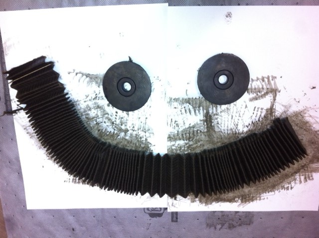

Lelix's Avatar
Joined: Jan 2012
Posts: 136
From: Toronto
2003 E55
Originally Posted by regor60
Dealer admitted first person gave me bad info.
It is as expensive as has been discussed here and they actually don't recommend doing it. And I'm not.
Thanks
Good call
