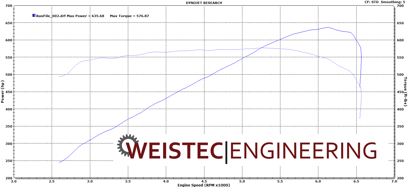

We are excited to get Craig up and running properly. We just finished up a similar setup in house that made great power.
Mods include:
Weistec M113K Supercharger System
Weistec Cold Air Intake Option (SL55 Model)
82mm Throttle Body Upgrade
Weistec Trunk Ice Tank
Weistec Dual Pass Heat Exchanger
Weistec TCU Upgrade
Mid length headers / high flow cats
100 Octane for added safety on stock motor
15psi at redline
We purposely tapered the power up top to keep stock internals in tact however we can easily hit 700HP at the wheels if it had our internals. Cheers guys!

Damn, look at that torque "curve". I wonder how far down the rpm range you'd have to go to really see less than 500 ft-lbs. Reminds me of the saying "my car makes more torque at idle than yours does at its peak."

Wow!!! Those are rather imposing numbers on a 55k with the mods listed ... and how impressive is the torque curve - certainly shows the potential of the Weistec blower

Yeah, the tq curve is nice a flat across the rpm range. Big displacement blowers like these are known for it.
