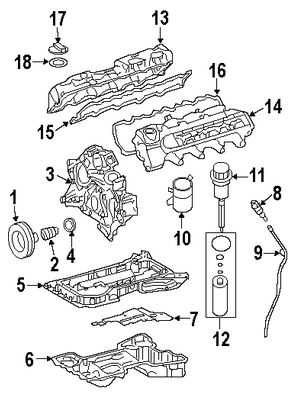

The latest one, I found that there is oil leak around the oil fill cap. From the pic, should I replace the O-ring (18) only, or I need to replace the whole assembly (10, 11, 12)?

18 only. 10,11,12 is the filter assembly.

there could be another leak at the base of the oil fill extender(plastic thing cap goes on). it takes the same seal as the oil cap, but you have to remove the valve cover to get to the screw that holds it on
