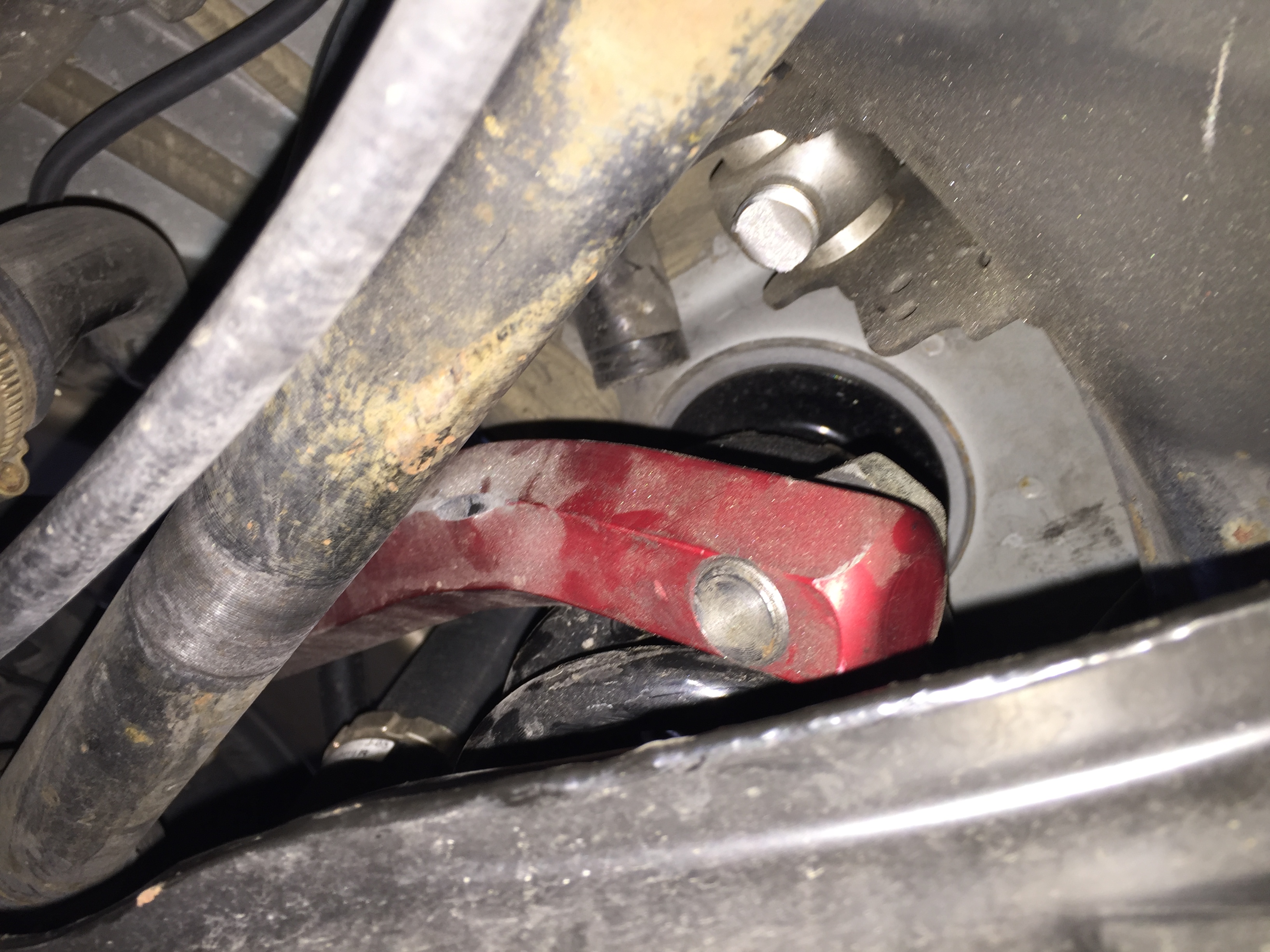

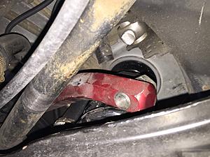

I WOULD NOT RECOMMEND THIS JUNK TO ANYONE!!! YOU GET WHAT YOU PAY FOR LEARN FROM MY MISTAKE SPEND YOUR MONEY ON REAL PROVEN TESTED SUSPENSION OR STICK TO YOUR OEM STUFF iTS BETTER QUALITY ANYWAY.

wow. that sheared right off.

It hit the axle and snapped the spherical tie rod end? shooooot. how low was the car? Did you hit a huge bump on the road loaded?

It's not junk but it does need a bit more development. FWIW, I removed and returned mine immediately after I noted, while installing, when the suspension is at full extension,( i.e. car "lifting" over whoop-de-do's in the road), the camber bars would bind and put the entire weight of the swing arm onto the heim joints' bolts' shafts.
This was a potential failure mode with which I did not feel comfortable. Seeing 03svtkiller's post reinforces my decision to return the set.
On the plus side, Shardul immediately refunded my money and I was only out shipping (well...maybe a few hours of my time). A small cost in my opinion. Development takes time and money and input from the audience. I have no complaints with Shardul, I am pleased and satisfied with my interactions with him, and I will highly recommend him to anyone dealing with Mercedes.
Here are my notes. All it needs is one more bend in the aluminum bar and the clearance would be fine. FWIW, this was January 2015.
Alternatively, the Heim joint should be threaded into the aluminum bar at a 30 degree to 45 degree angle and the end of the aluminum bar should be ground or cut off at a 30 degree to 45 degree angle to prevent interference with the sub-frame.

Looking at the photo of 03svtkiller's failed heim joint, here is my observation for what it is worth. It matches with my evaluation when I returned the set.
Easy fix for this. This kit has potential so don't give up on it.

crap...so I just bought a set... should I return them? the MB Arts don't look any better to be honest. looks like they would still bind. might take a bit more abuse before failing but same story.
thoughts?

It may have just been the tolerances on my car. The binding would only occur at full extension of the suspension. That would only occur if the car was picked up on a lift or if it was lofting off the ground by driving at an excessive speed over a hill. The first (the lift) wouldn't be a big deal. The second shouldn't be occurring at all.
