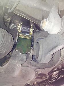

Also to avoid cracking since the motor torques, strap the drivers side down

Not a flex-pipe connection?

No, no flex pipe, the drivers side has been strapped down . Torqu strap, old school GN style.
Ratchet tie down is welled to the frame and keeps the motor from torquing too much and saves your mount as well.

Could you post a photo of your torque strap set up?

Ya, I will, it won't show much, just the ratchet part and it wasn't clear.
I'll post it in a few

Here it is
It's welded into the frame doesn't bother anything at all
