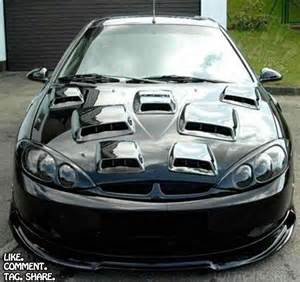

From: West
E55 AMG
Thumbs down
This would be badass though!

Old Jun 2, 2015 | 04:30 PM
Hulk's Avatar
Joined: Dec 2011
Posts: 4,599
Likes: 102
From: Florida
A Merc
VOMIT lol
The scoops should be turned around for heat extraction. Duh.
With that many scoops I'm not sure it would matter ;-)
