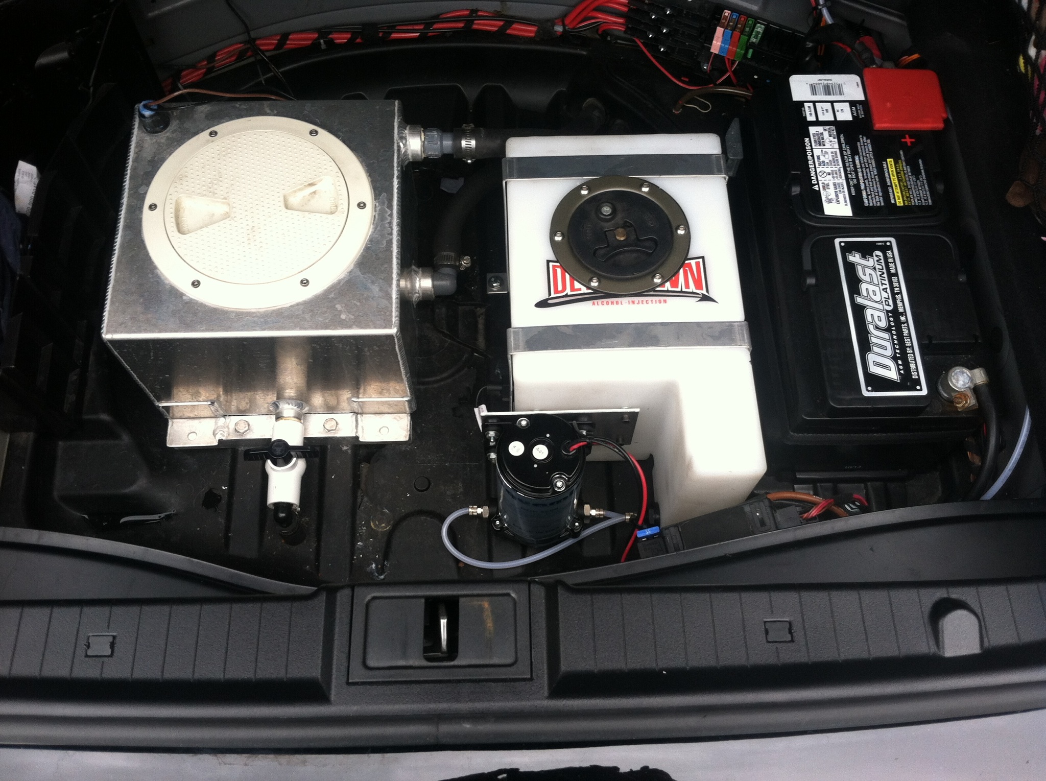

Jun 18, 2015 | 04:58 PM
All this in the spare tire well, plenty of room for Denroll's dead hookers or RBJ's golf clubs in the trunk.
Has anyone done Water/Meth with Killer Chiller without Trunk Tank?-download_20150618_165350.jpeg
