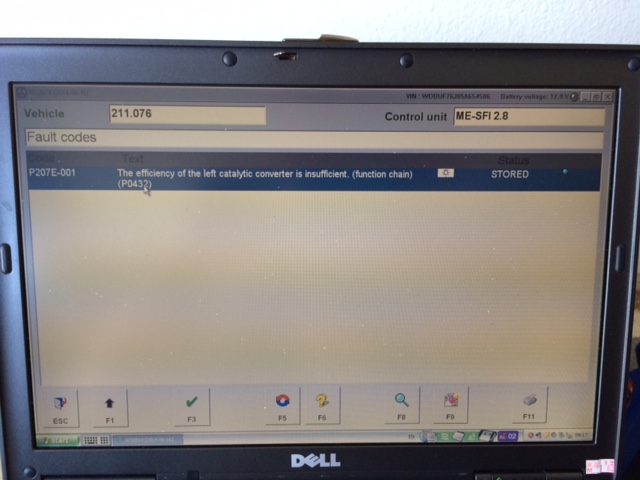

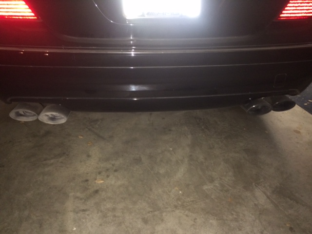

Hey all!
Just wanted to post a picture of what I think is a bad catalytic converter on my 2005 E55 driver's side. I noticed that under WOT a cloud of smoke emerges that is grey and there is some powder like material on my tail pipes afterward. No smoke at idle or normal driving. STAR system says I need a new catalytic converter on driver's side.
Question: I would like to get some high performance racing type cats at hopefully a good price, anybody have any recommendations?
Thanks!
Ian

Hate to say this but this does not look like a bad kitty problem. Do a compression test, especially check compression on #8 vs others

When a cat breaks up it looks like gray dust.. You could just have a busted cat. No power loss, freight train sounds promising. Do you hear any particles bouncing around the exhaust when the car is on? Put it up on a lift or jack it up and tap around the exhaust piping where the cats are and listen for anything loose. When the car is off.

I have tapped the exhaust and don't notice very much loose sounds particles. I'm still hoping it's the cat. I haven't pulled the plugs or check the compression yet because I've been swamped at work but will do it ASAP. I am off all next week and plan to tackle this project.

I checked the pre-cat O2 sensor exhaust pressure and it was 0 (no obstruction to flow) on the left side.
I then took it to my local mechanic and they put a bore scope in the post-cat o2 sensor and indicated that my entire left catalytic converter had disintegrated! There were parts of catalytic material dust in the downstream pipe as well indicated this was obviously a catalytic converter failure (disintegration). The right side was starting to rattle and go bad as well. Btw, I have secondary cat / resonator deletes.
I admit, I haven't checked the spark plugs and compression yet but promise to do so shortly and will post an update.
