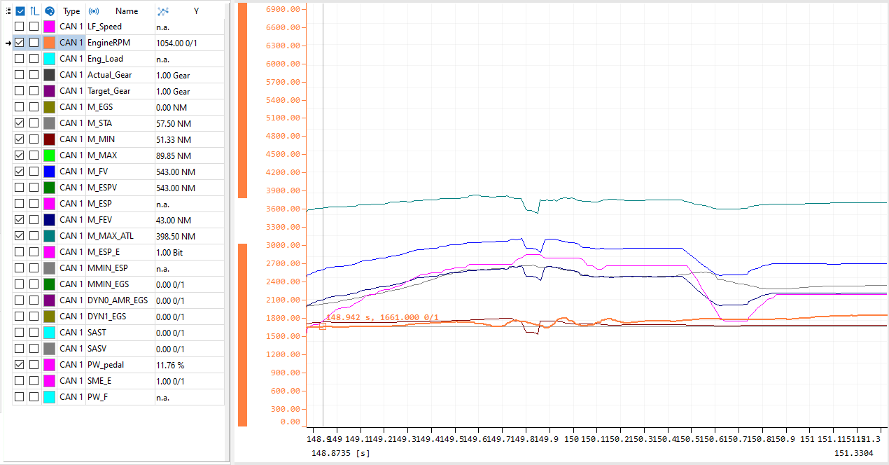

I know that this thread is dreadfully old. The problem is even older, but I'm still having it. In my case, I have an M113K in a Crossfire. Being a much lighter car than a W211, the hiccup (which is so much more than a hiccup!) is downright violent. The Crossfire has had this issue for a few years, now, and in that time many things have been tried. Lots of parts thrown at the problem, tunes, and time. The car itself is constantly evolving, and in the time since the hiccup arrived, it has had an engine replaced, a different supercharger (new bearings, different snout, silencer slots welded, etc), different pulley setup (83mm upper to 180mm lower/stock upper), each and every sensor replaced, wiring checked many times over, two sets of injectors, several different throttle bodies (stock and 82mm), brand new bypass valve, alternator (to rule out electrical noise), and quite a bit more. Later I designed a brand new set of CAN data logging tools, and was able to capture the moment a hiccup happens in the attached graphic (see the almost square dropout in the 4 torque graphs?).
Here's what I know for sure:
1. It's not a mechanical issue
2. There are no air leaks (checked with a pressurized smoke machine)
3. No wiring faults or voltage supply drop outs
4. Fuel pressure is steady
5. Throttle body independent (stock and 82mm both do it)
6. Not boost dependent (happens in vacuum, not boost)
7. Is not supercharger clutch engagement (more on this below)
8. Is not temperature dependent
9. Is repeatable, and coincident with the timing of supercharger clutch engagement
10. Tunes that keep the supercharger engaged 100% of the time do not exhibit the hiccup
So many think it is supercharger clutch engagement, as did I, until I ran this simple test. Using a spare clutch magnet, I unplugged the clutch, and plugged it into the spare magnet. Securing the magnet under the hood, I went for a ride, and sure enough, the hiccup is there, and just as bad as ever! Some have suggested that it is the throttle body or bypass valve doing something, and it sure could be. The onboard data reporting is far too slow to show it, though.
Before I try more, I wanted to reach out here to the ones who have been in these cars the longest. What is the no-kidding solution? Yes, I see go to this tuner or that tuner, but I am wanting technical details. What in the tune is actually causing the issue? Is it a torque limit being exceeded? Is it a diagnostic failure? Someone here knows, and I am hoping that these cars are now old enough that someone can share a practical solution or information on how to achieve one, without fear of loss of profit. Thanks!
Attached Thumbnails Is there a fix out there for the 2500rpm tps hiccup?-graph.png

I may have missed this but have you discussed just removing the clutch and running clutch-less?
Old Oct 3, 2024 | 06:34 PM
  #50
nemiro's Avatar
Joined: Jul 2021
Posts: 310
Likes: 36
From: Holt, FL
2004 Crossfire (w/M113K), 2008 Crossfire (w/M156), 2008 ML63, 2018 AMG GT
I have not, but I have run tunes where the clutch is 100% engaged. This is OK, except that this SC sounds like a cement mixer full of gravel at idle, and it is generally not too efficient to be spinning it while running down the highway with the cruise on. In other words, would like the clutch portion to operate as intended, sans hiccup.
