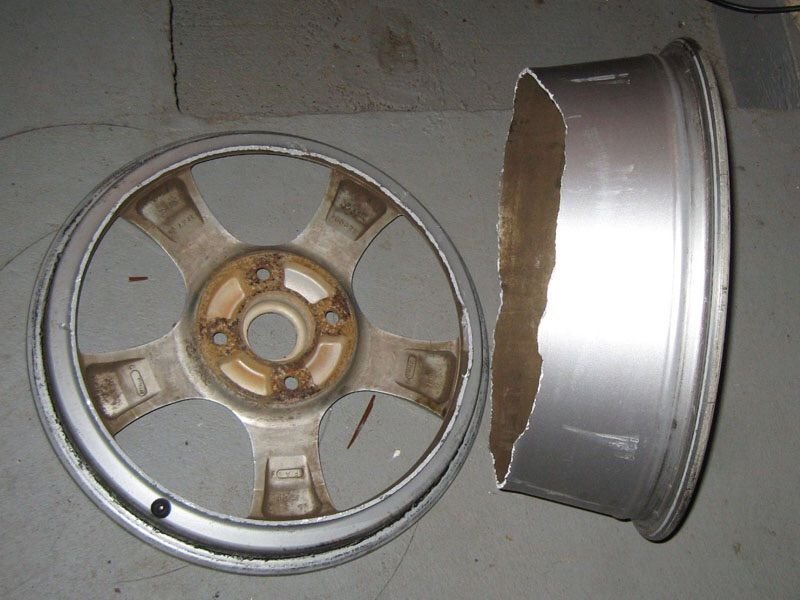

Some cases of cracked wheels that could be dangerous.
This could happen with a cheap aftermarket wheel
