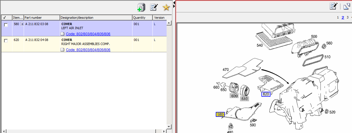

So do you guys think I need to add the additional cover? i can order it if the consensus is that it is necessary, will it fit properly on a 2003 model?
Also what is the exact part number that I order for that additional cover? i saw 2 different A211 numbers....
from my research online i think its this part number not the one post in a previous post: a211 832 0308
Also as mentioned before that one of my plastic undercover panels was removed from the vehicle but i was told its not a big deal, could that have caused an ECU malfunction?

is it part a211 832 0308 ? i think thats the new part number for our models for the additional cover, i didnt know if the additional cover was needed cause i also heard that if that area gets too hot that can also cause malfunctions?
If your car is already at the dealership, why don't you simply ask them for an estimate on replacing that part?
They will have the correct part number on the estimate.
If I were you, I would also replace the missing undercarriage panel. These are 90k cars. The engineers designed each piece with a reason.

they said that part number above finance was just wanting to confirm with people here who have that part already,
having a 2nd cover over top of the fuse box wont affect it in a negative way in terms of too much heat would it?
The part numbers for both covers are list above.
